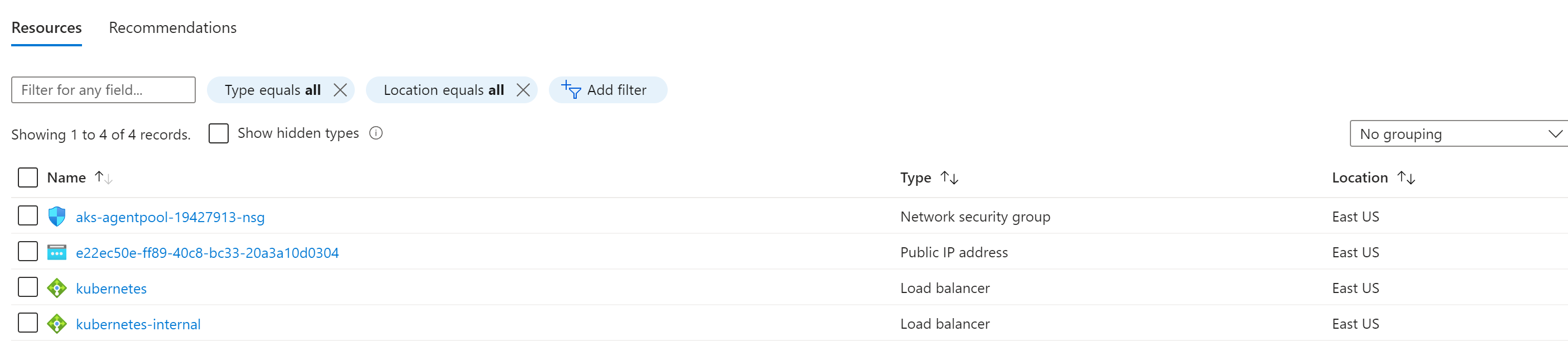

Further investigation finds that the AKS managed resource group (created by ACA) did not delete properly. In particular, the load balancer remained in a AKS managed resource group - a group that I cannot delete (likely because it is managed by Azure). So now I am stuck. Just leaving the resources there is of course not an option since load balancers do cost money to run.
Here are some screenshots to help illustrate my problem:
The managed resource group created by ACA shows some resources left over:the managed resource group created by ACA shows some resources left over

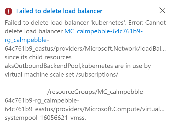

The error I got when i try to manually delete the load balancers:
I do not think I have a way to access the vm scale set or backend pool set by k8s via ACA. Any help will be appreciated!
Edit: after one evening, the resources clean themselves up and I am able to clear everything.
