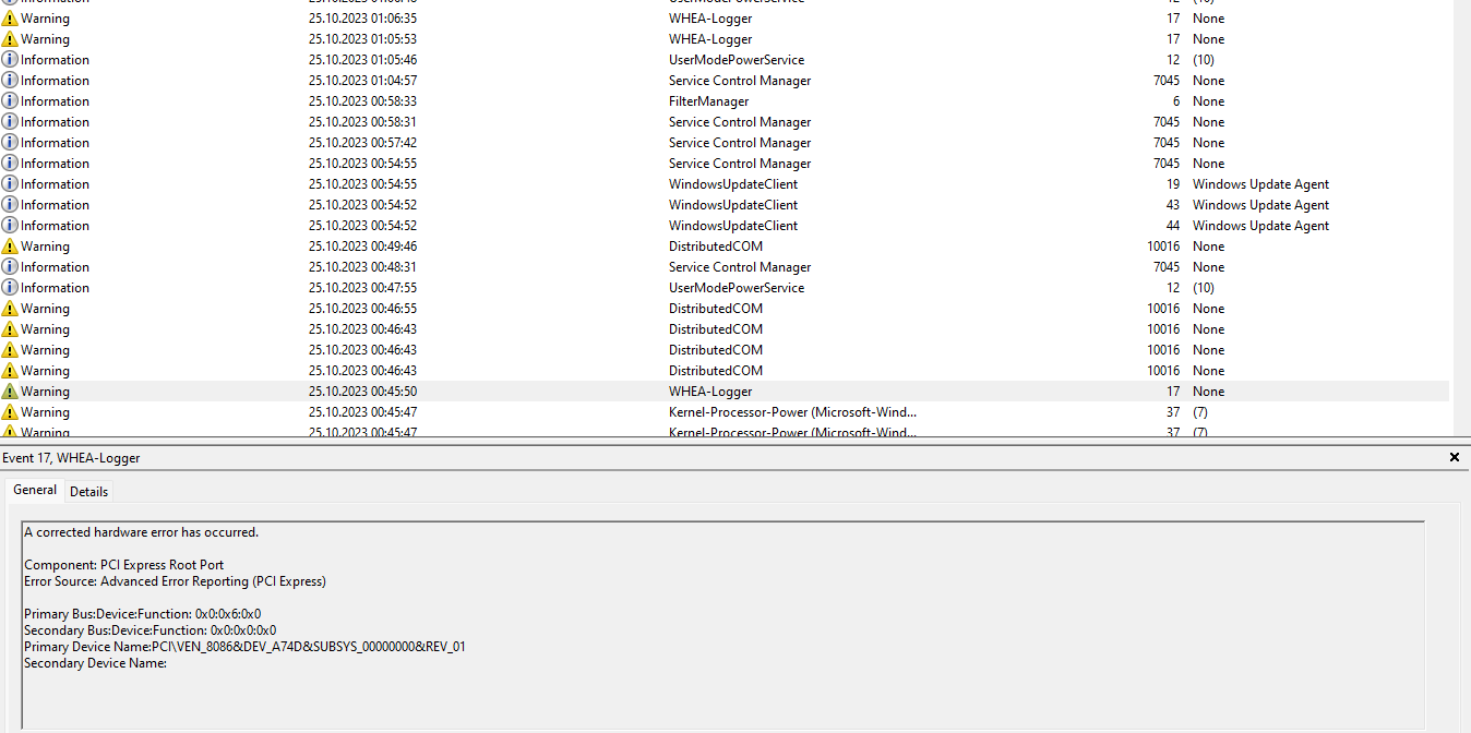

Errors :
WHEA
whea
A corrected hardware error has occurred.
Component: PCI Express Root Port
Error Source: Advanced Error Reporting (PCI Express)
Primary Bus:Device:Function: 0x0:0x6:0x0
Secondary Bus:Device:Function: 0x0:0x0:0x0
Primary Device Name:PCI\VEN_8086&DEV_A74D&SUBSYS_00000000&REV_01
Secondary Device Name:

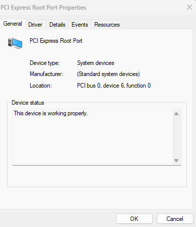

Also the device in the device manager seems to be working correctly if im searching it by Primary Bus:Device:Function: 0x0:0x6:0x0

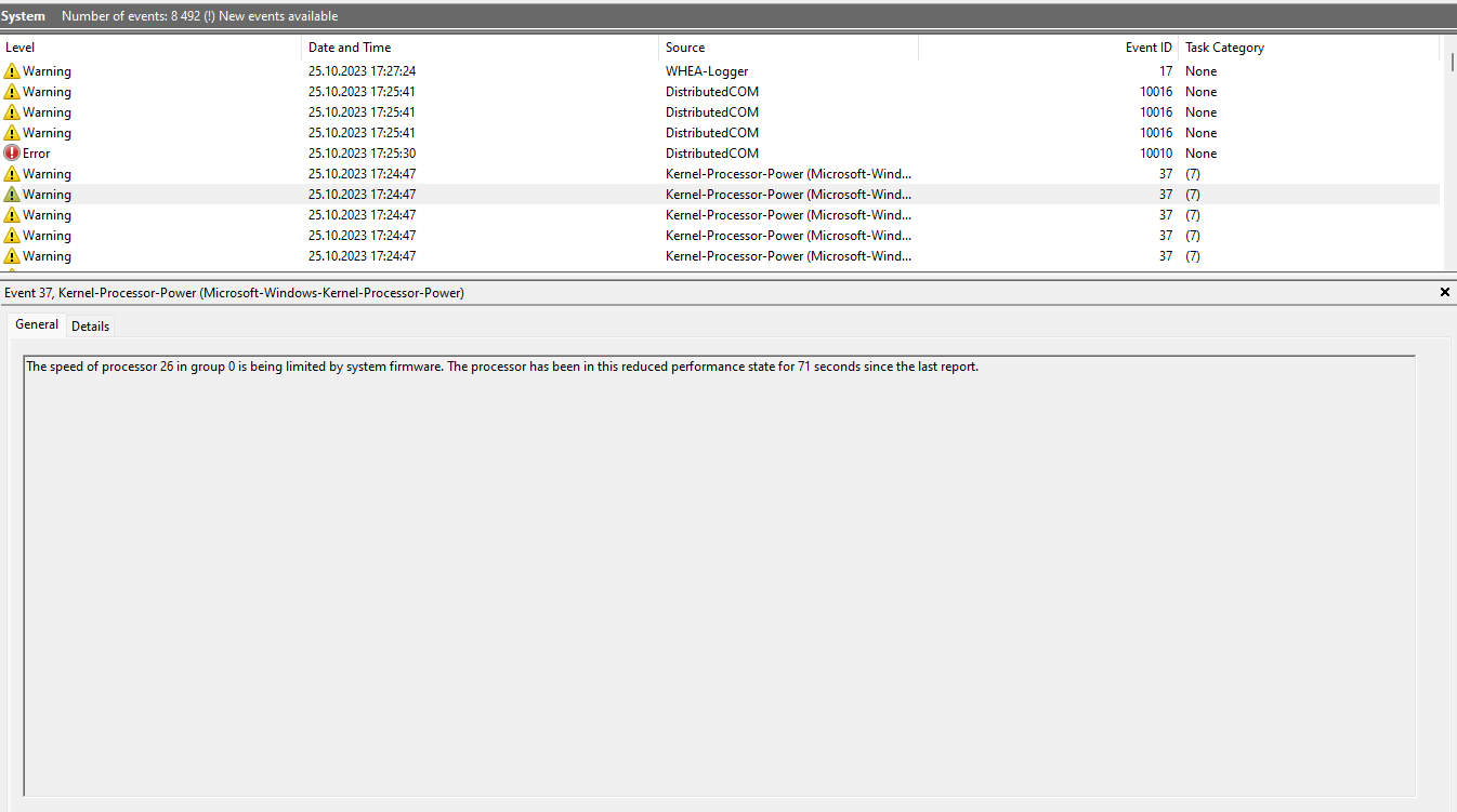

Kernel : From around 16 to 27 processor.
Screenshot 2023-10-25 172933
The speed of processor 17 in group 0 is being limited by system firmware. The processor has been in this reduced performance state for 71 seconds since the last report.
The speed of processor 18 in group 0 is being limited by system firmware. The processor has been in this reduced performance state for 71 seconds since the last report.
The speed of processor 19 in group 0 is being limited by system firmware. The processor has been in this reduced performance state for 71 seconds since the last report.
e.t.c.
