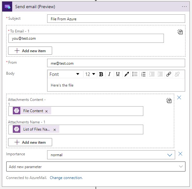

The above step is triggered by the arrival of a file in a given folder. There is a Get Blob Content step before the Send Email which picks up the details of the file.
When I add a file to the folder the file is correctly detected and is successfully sent as an attachment to the email. This works with every type of file that I have tried except for .csv files (which, of course, is the type I'm working with).

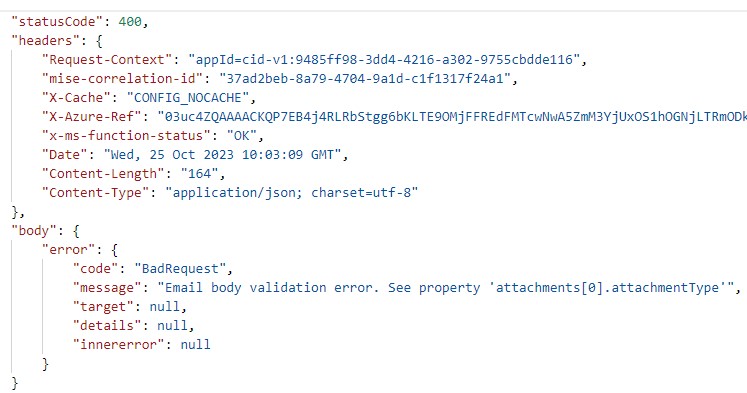

When a csv file is added to folder, the logic app fails at the Send Email step and gives the following error:LogicApp02

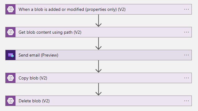

Here's the complete flow diagram of steps in the logic app. I don't think that the last 2 steps impact on this problem.
LogicApp03

    Hello, @jhTuppeny - Thanks for reaching out. It looks like the .csv type is among the allowed types and I'm able to reproduce the same issue you're hitting with the Azure Communications Services connector. I suspect it's so because the connector is in the Preview stage but I'll clarify & confirm with the owning team and share my findings here.
    UPDATE: I believe the Connector's page is meant to list these types under its "Known Issues and limitations" section. I've requested confirmation internally but it's likely a supportability issue that'll be resolved when the connector goes GA.
