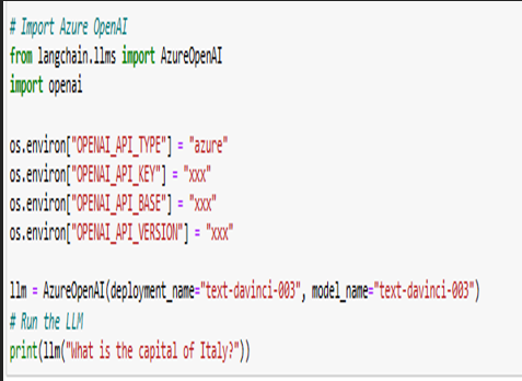

    There are ways that you can try using the LangChain library installed (you can do so via pip install langchain) in python with the chatbot been developed and connect that with the Azure OpenAI and connect it. It supports the vector search and will allow you to have the customized chatbot aswell.
