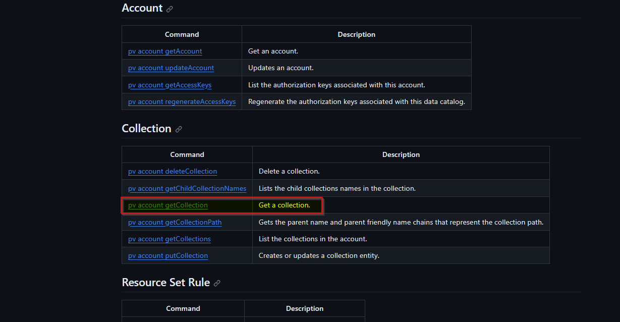

    All of the tayganr/purviewcli: Microsoft Purview CLI (github.com) are NOT powershell, it is its own shell command.
    Video: Could you please try Visual Studio Code instead of Powershell as demonstrated in this video: CLI wrapper to Microsoft Purview APIs (purviewcli)
    You should just call pv entity read --guid 'abc-123' and it will pull the content down in json.
    If you would like to explore Powershell cmdlet, it's a different pacakge: Azure/Azure-Purview-API-PowerShell (github.com)
    Hope this info helps. Let us know how it goes.

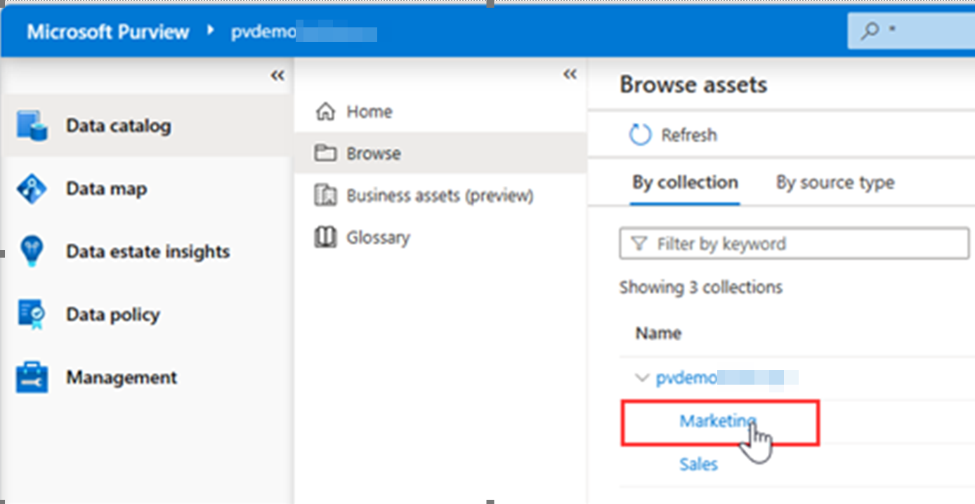

    @Maria Diana , Have you tried running the command pv search query ? I think you can get the data for collection level by using pv search query
    Also have a look at this https://github.com/mdrakiburrahman/purview-collection-aggregator/blob/main/explore.ipynb it might be useful
