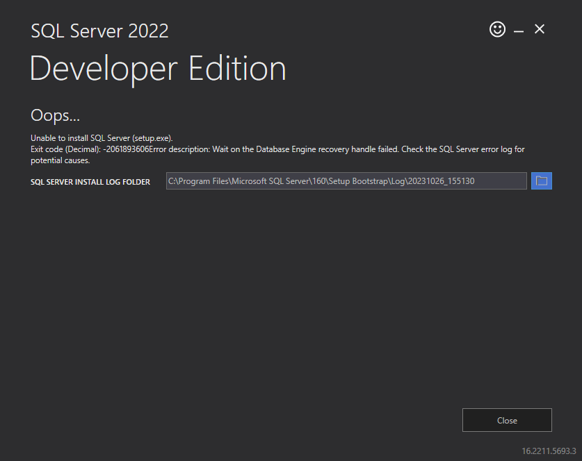

unable to install sql server (setup.exe) Exit code (Decimal): -2061893606

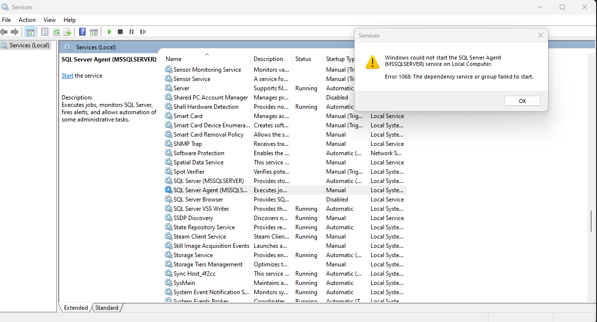

hello, I have spent a lot of time trying to fix this error, nothing online has been enough to completely fix this issue and I cant seem to identify the cause myself. after the SQl basic installation I am able to find the newly installed SQL service however its is not running and when I try to manually turn it on this error pops up.

here are the detail and summary logs, I looked inside but couldn't understand much.

The message Wait on the Database Engine recovery handle failed is a generic error that means that SQL Server did not start when Setup wanted to run configuration steps. To understand why it did not start, you need to look in the SQL Server errorlog, which you find in C:\Program Files\Microsoft SQL Server\MSSQL16.MSSQLSERVER\MSSQL\LOG\ERRORLOG.
If you see a message about 256 misaligned reads, you are running into a known issue where Windows 11 for some disk drives reports a sector size that SQL Server does not cope with. Microsoft has published an article with workarounds for the problem.
If you don't see the message about misaligned reads, feel free to upload the errorlog here, so we can look at it. You will need to rename to ERRORLOG.txt for the forum software to accept it.
