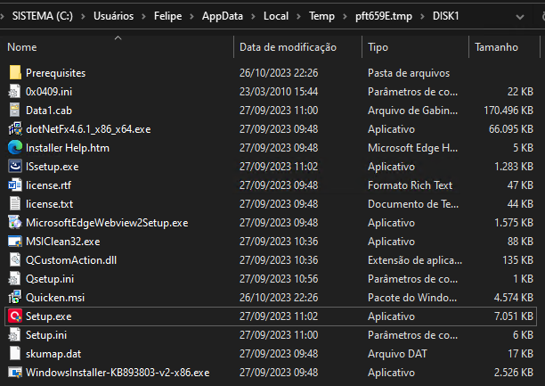

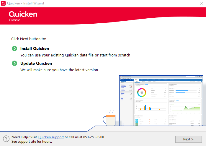

    I would like to help with some more information. When running the "Quicken.exe" setup, before clicking NEXT, you can see that the wizard copies all application files to the path:
    %Temp%: C:\Users\UserProfile\AppData\Local\Temp\pft659E.tmp\DISK1User's image
    I believe you can explore the files (quicken.msi, setup.ini and qsetup.ini) by creating a powershell or batch and then create the application in Intune.
