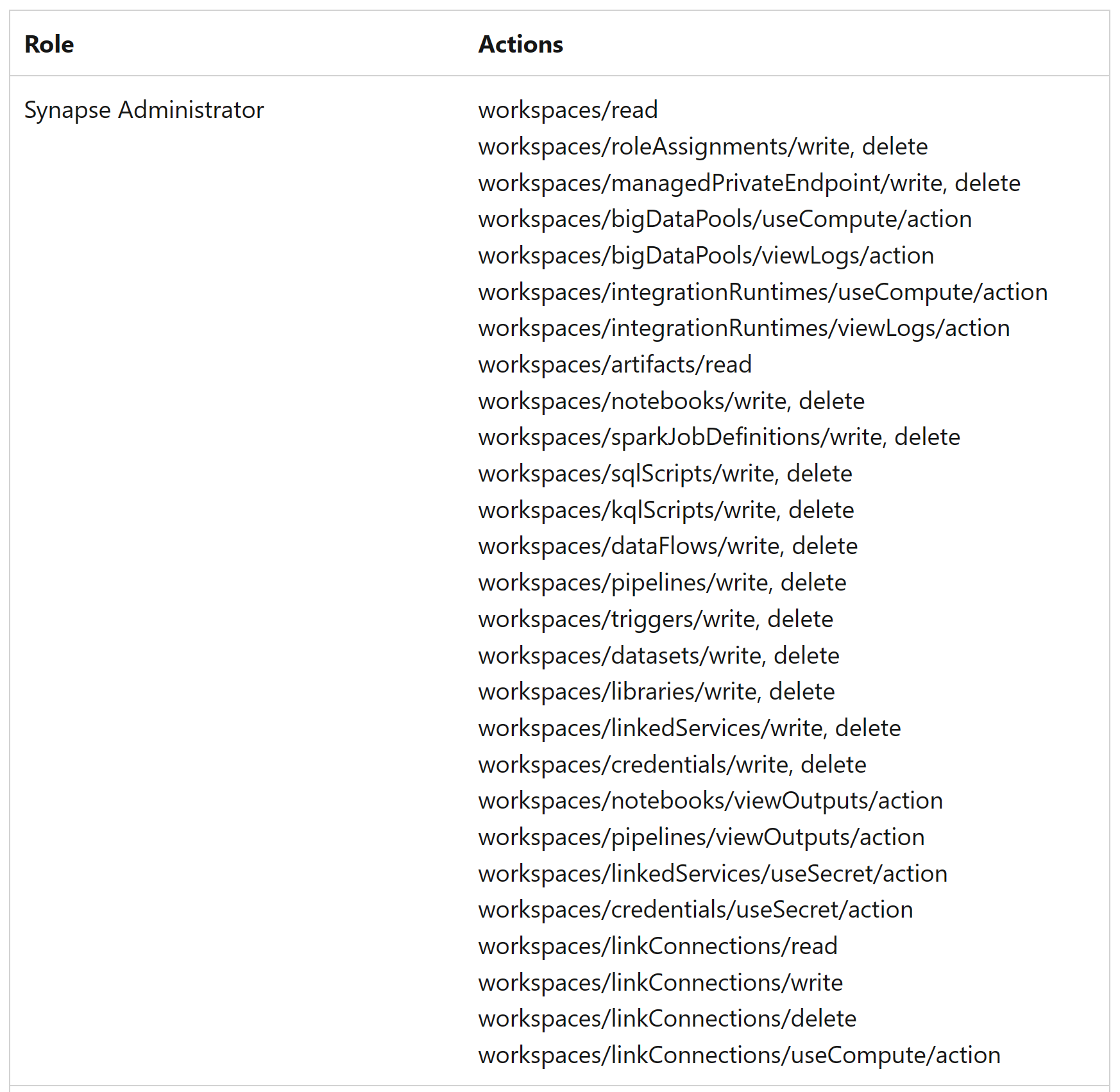

    According to the official documentation: Synapse RBAC Roles
    The following table lists the built-in roles and the actions/permissions that each support.

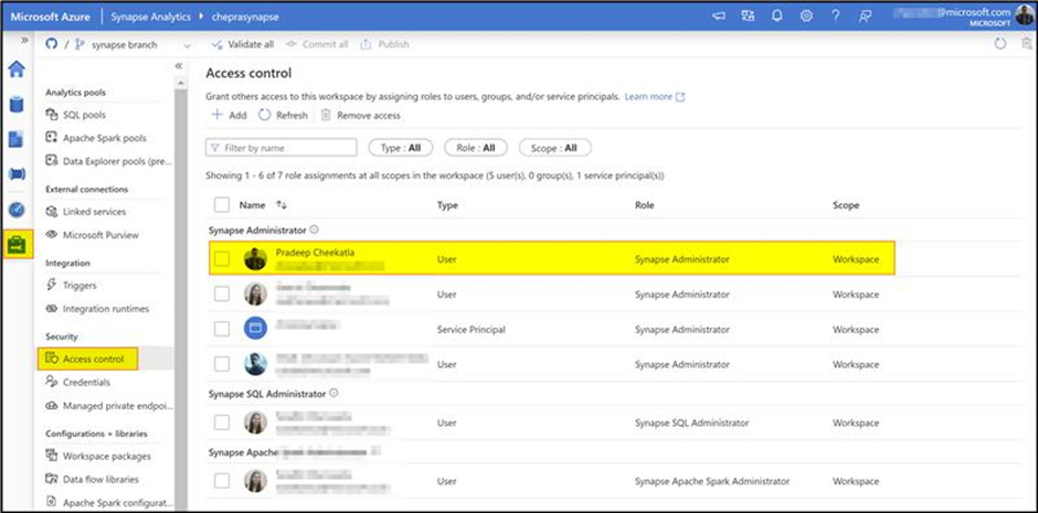

    Adding permission on the Synapse Portal: Access control: Synapse AdministratorUser's image

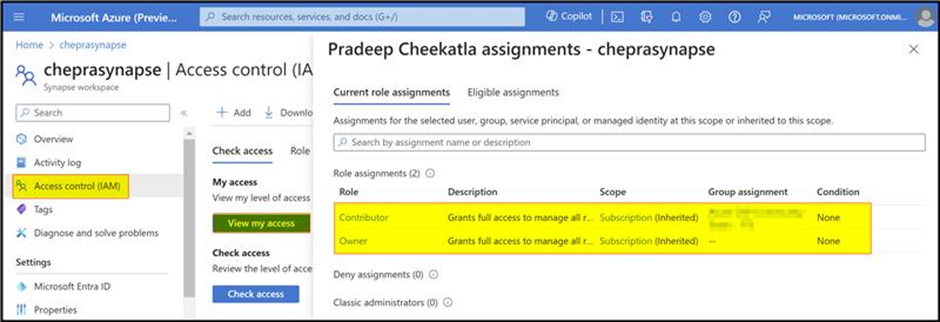

    Make sure you have required permissions to access workspace:
    • From Azure Portal under Synapse Workspace, user needs to have Owner/Contributor permission.
    • From Azure Portal under Synapse Workspace, user needs to enable correct IP address under firewall settings.

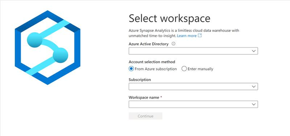

    After grant the required permissions, you can try the below options:
    Option1: Try to manually login by going to the https://web.azuresynapse.net and sign into your workspace.
