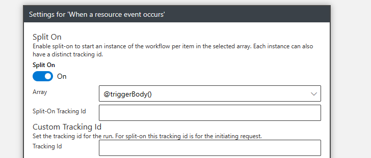

I'm unable to run my azure logic app. It is showing error "failed to start a logic app run, undefined". Within the activity log of my azure logic app, I was observing Trigger Run failing with the error as seen in below screenshot. Can someone please help why this error is seen and what should I do to run my azure logic app?

    It looks like you are using the When a resource event occurs triggers (event grid connector) and as per the error message under the setting you can see the Split On property enabled for your trigger so that means per item in your selected array it will have the district tracking it. If you have disabled it then all the events will process by the same instance for a particular time.
    If there is only the single json object and not the array then you can disable it.
