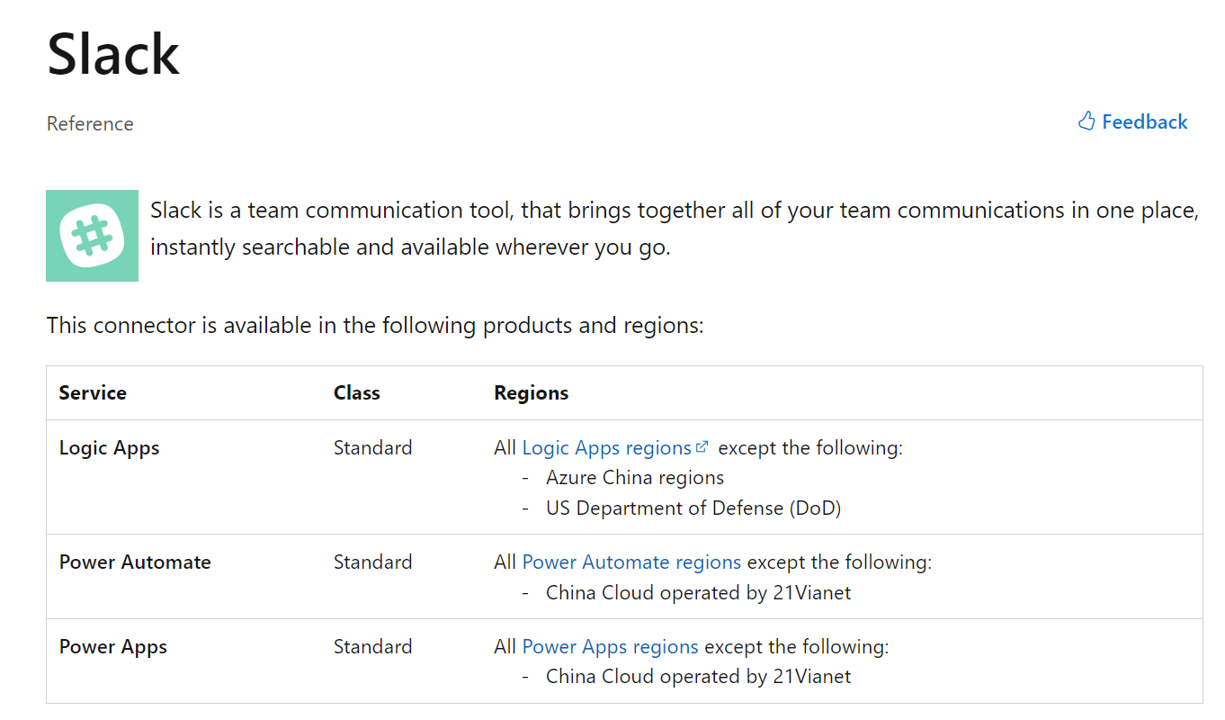

    Logic Apps provides a no-code flow diagram and supports Slack:

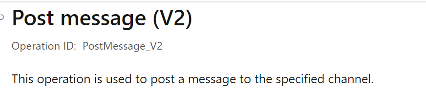

    You can post messages:

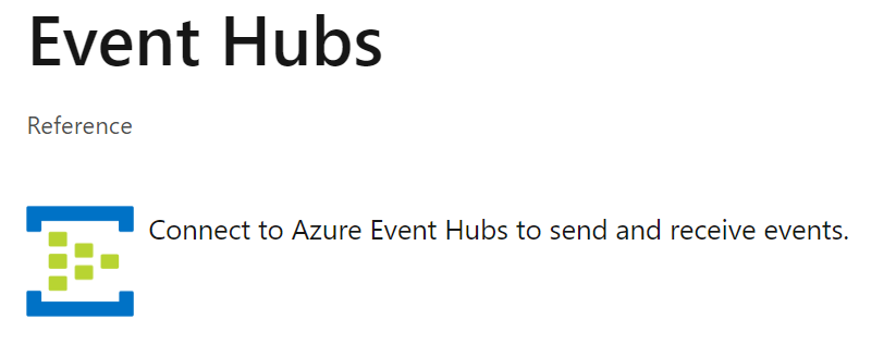

    To send these messages, you need to listen for Event Hub messages, using the event hub connector:
