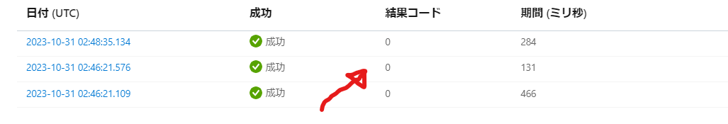

I would like to receive alerts when a function executed via an Event Hub trigger fails. When achieving a similar outcome with an HTTP trigger, I used a query like the following to configure alert rules and receive alert emails.
ApiManagementGatewayLogs
  | where ResponseCode > 499
However, functions executed via the Event Hub trigger do not record status codes as shown below, and because they do not go through API Gateway, I believe they are not logged in ApiManagementGatewayLogs.
I would greatly appreciate any advice on how to solve this problem.
