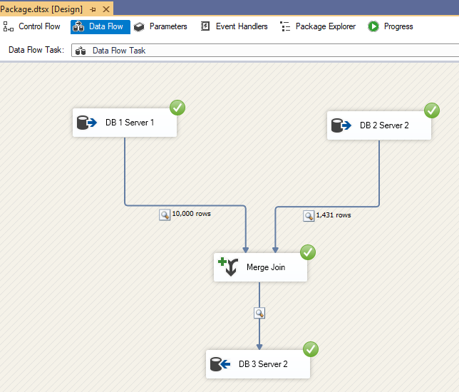

The goal is to get this query into a table on a third database using a join on a unique identifier and several filter criteria. One of the source databases has millions of records.
I have attempted to execute this by creating two OLE DB Sources feeding into a Merge Join with an OLE DB Destination. However, I get 0 records written in the OLE DB Destination. Please see Data Flow diagram below. DB 2 and DB 3 are on the same servers. DB 1 on Server 1 has millions of records. The Data access mode for DB 1 is using a SQL command text. I am to preview the SQL command successfully. The SQL command text is:
SELECT Column A, Column B, Column C, Column D, Column E, Column F
FROM DB 1
WHERE (COLUMN C > '1/1/2020') AND (COLUMN X > '10/01/2023') AND (COLUMN Y = 'USA')

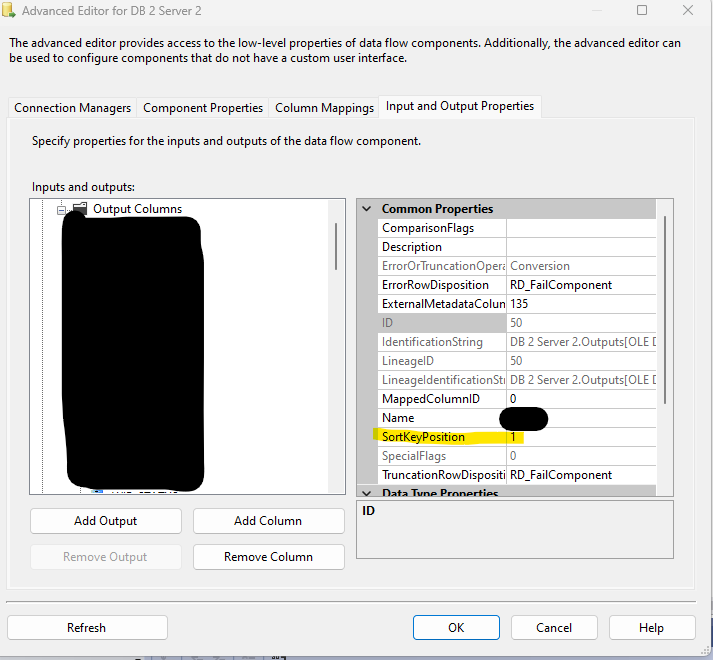

The current Merge Join is using an inner join. I have also set the IsSorted property to True for the OLE DB Source Output and set the SortKeyPosition to 1 for one of the Output Columns.

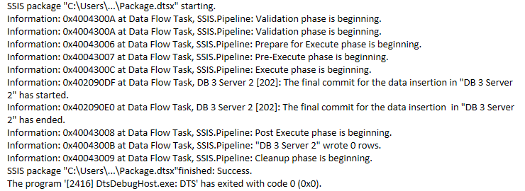

Some of the results in the Output Debug are listed below:
Information: 0x4004800C at Data Flow Task, SSIS.Pipeline: The buffer manager detected that the system was low on virtual memory, but was unable to swap out any buffers. 4 buffers were considered and 2 were locked. Either not enough memory is available to the pipeline because not enough is installed, other processes are using it, or too many buffers are locked.
SSIS package "C:\Users....\Package.dtsx" finished: Success.
The program '[9752] DtsDebugHost.exe: DTS' has exited with code 0 (0x0).

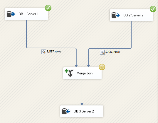

    • Temporarily just for test, you can try to limit data volume from the DB1:
      SELECT TOP(10000) * FROM ...;
    • Because JOIN is done in SSIS Data Flow Task (DFT) that machine will need more available RAM memory. No question about it.
