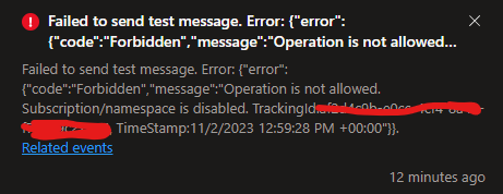

From past couple of days we are facing issue with Azure Notification hub service.
Earlier the issue was with the Subscription billing, where one of our past payment was failed so the subscription got disabled and the Notification service was not working.
At this time I was not able to see the APNS and GCM credentials. It showed This credentials is not a function message.
But after that we updated the payment information and then subscription was restored.
Now I can see the APNS and GCM credentials. And I assume that the Notification Subscription also was restored. But when I try to send any notification from Test send I still get the forbidden message. Please see the below screenshot.
Please help us resolve this issue.

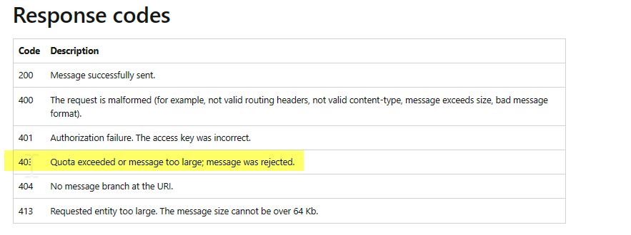

    2. Other push notifications are failing with 403 error. As per the REST API documentation 403 Response code means either quota has exceeded or message too large or rejected. Try send the notification with less message/payload and see whether it works.
    Feel free to reach back to me If you have any further questions on this.
