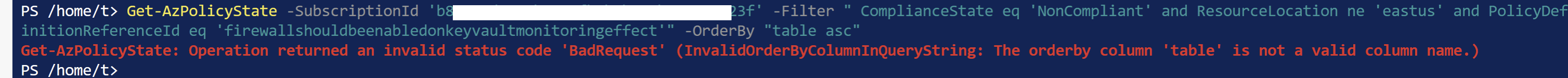

The way the results was displayed wouldn't work for my report as It will need to be presented using excel or csv, when I tried to pipe the output to a table I get the error below. The azure subscription has a lot of policy items, so ideally I am trying to write the script such that it will export to csv or excel.
Get-AzPolicyState : Operation returned an invalid status code 'BadRequest' (InvalidOrderByColumnInQueryString: The orderby column 'table' is not a valid column name.)

    The InvalidOrderByColumnInQueryString error mentioned here is because of providing an invalid column name called 'table'. I was able to reproduce the error by running below command.
    Get-AzPolicyState -SubscriptionId 'xxxxxxxxxxxxxxxxxxxxxxxx' -Filter " ComplianceState eq 'NonCompliant' and ResourceLocation ne 'eastus' and PolicyDefinitionReferenceId eq 'firewallshouldbeenabledonkeyvaultmonitoringeffect'" -OrderBy "table asc"
    To resolve the error, provide a valid column name like Timestamp, PolicyAssignmentName, etc. For more information, refer this Azure document.

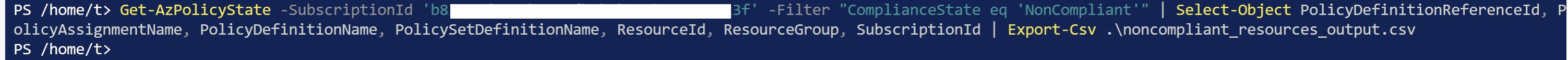

    On the other hand, if you are looking for a way to export the output to csv, use Export-Csv cmdlet as shown below.
    Get-AzPolicyState -SubscriptionId 'xxxxxxxxxxxxxxxxxxxxxxxx' -Filter "ComplianceState eq 'NonCompliant'" | Select-Object PolicyDefinitionReferenceId, PolicyAssignmentName, PolicyDefinitionName, PolicySetDefinitionName, ResourceId, ResourceGroup, SubscriptionId | Export-Csv .\noncompliant_resources_output.csv
    Let me know if you have any further questions with regards to this topic.
