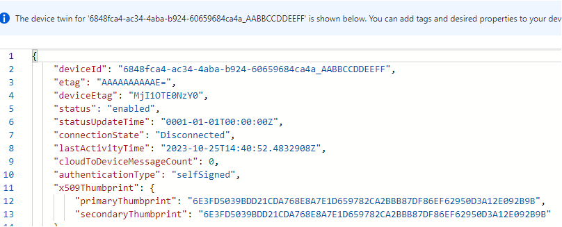

I made a test to see what happens if the device was provisioned by the Device Provisioning Service and had a certificate where CN was uppercase. The deviceId in the IoT hub matches the CN and sending data is ok.

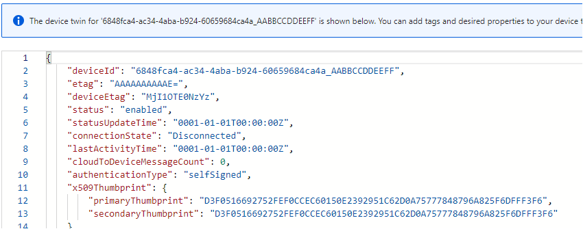

The same device in the IoT Hub is updated with the new cert thumbprint instead of creating a new device with lowercase.
Trying to send telemetry data or update the device twin (with any of the certs) now results in UnauthorizedError.
The only way to fix is to delete the device in the IoT Hub and then make the provisioning again. Then a device with lowercase is created.
