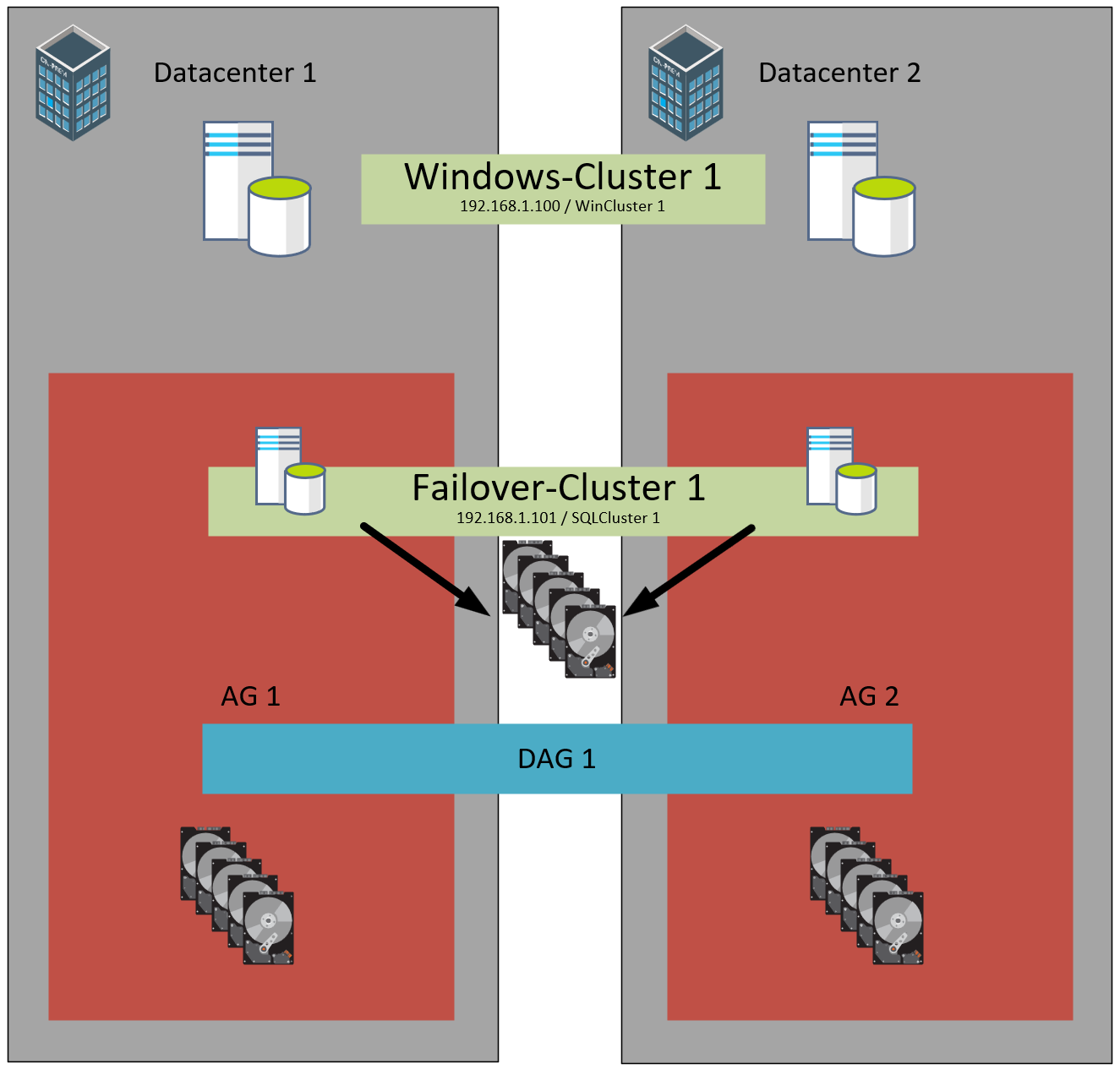

    I don't understand your environment, and please explain a little bit deeper.
    What kind of environment do you have? A failover cluster + a DR Standalone, a Standalone with Replication/Log-Shipping, or an Availability-Group Cluster with 2 or 3 nodes (+ DR node?)
    What do you want to achieve in what case... "just" a DR scenario?
    With any automation or all manual?
    Is that DR node just a DR node (nothing else!), or is it just another Standalone server that keeps a "replicate" of your production databases?
    Based on my understanding of your scenario, my stomach and my experience... I would suggest that a DNS change would be the easiest and most elegant method to move an application from server a to server b.
