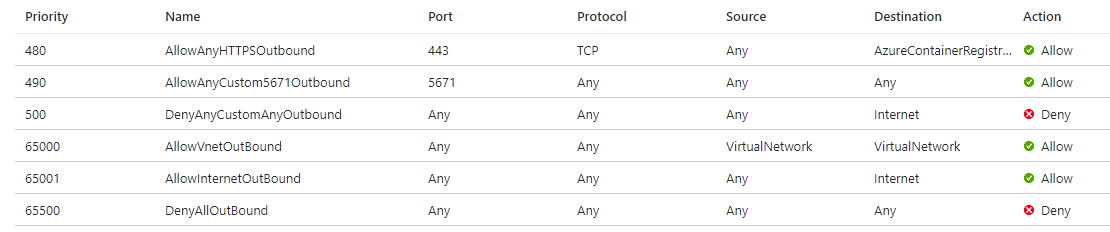

I have a azure container registry which contains some repositories. I want to pull these repositories images into my azure VM. The VM has RHEL 8 OS and Moby-cli and Moby-engine is installed for running docker commands.
The VM networking is configured to deny internet access and allow only port 5671 for all IPs and port 443 for azure container registry only. Below is the outbound port rules for the VM.

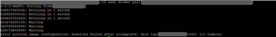

I am able to login to container registry using docker login command, but when I run the docker pull command it gets stuck and gives timeout errorUser's image
This VM is configured to run IoT edge runtime without internet. But I am facing issues while doing so. please help how can I resolve this issue.

    The issue you encounter is not directly Azure IoT Edge related. That runtime is unaware of how you manage your containers.
    Are you sure the container registry is accessible? Have you tried a 'ping'? Do you have the right credentials?
