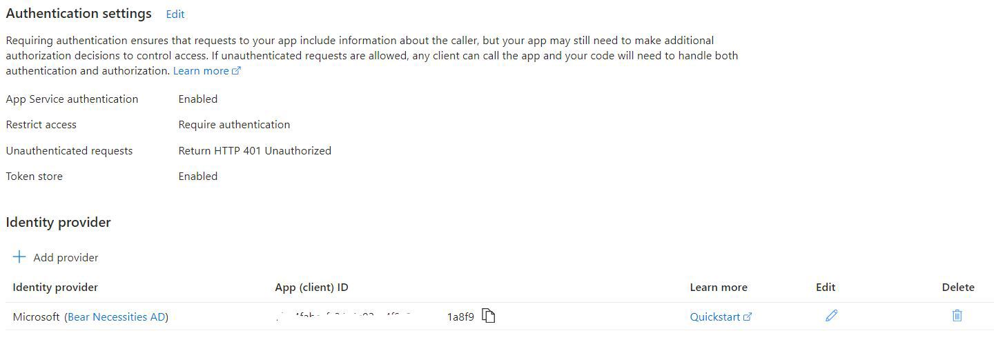

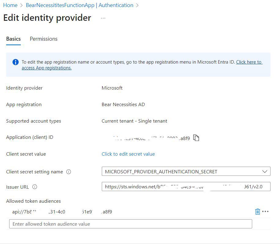

I have added Microsoft as the identity provider for the function app, using the same application registration. function auth settingss enter image description here

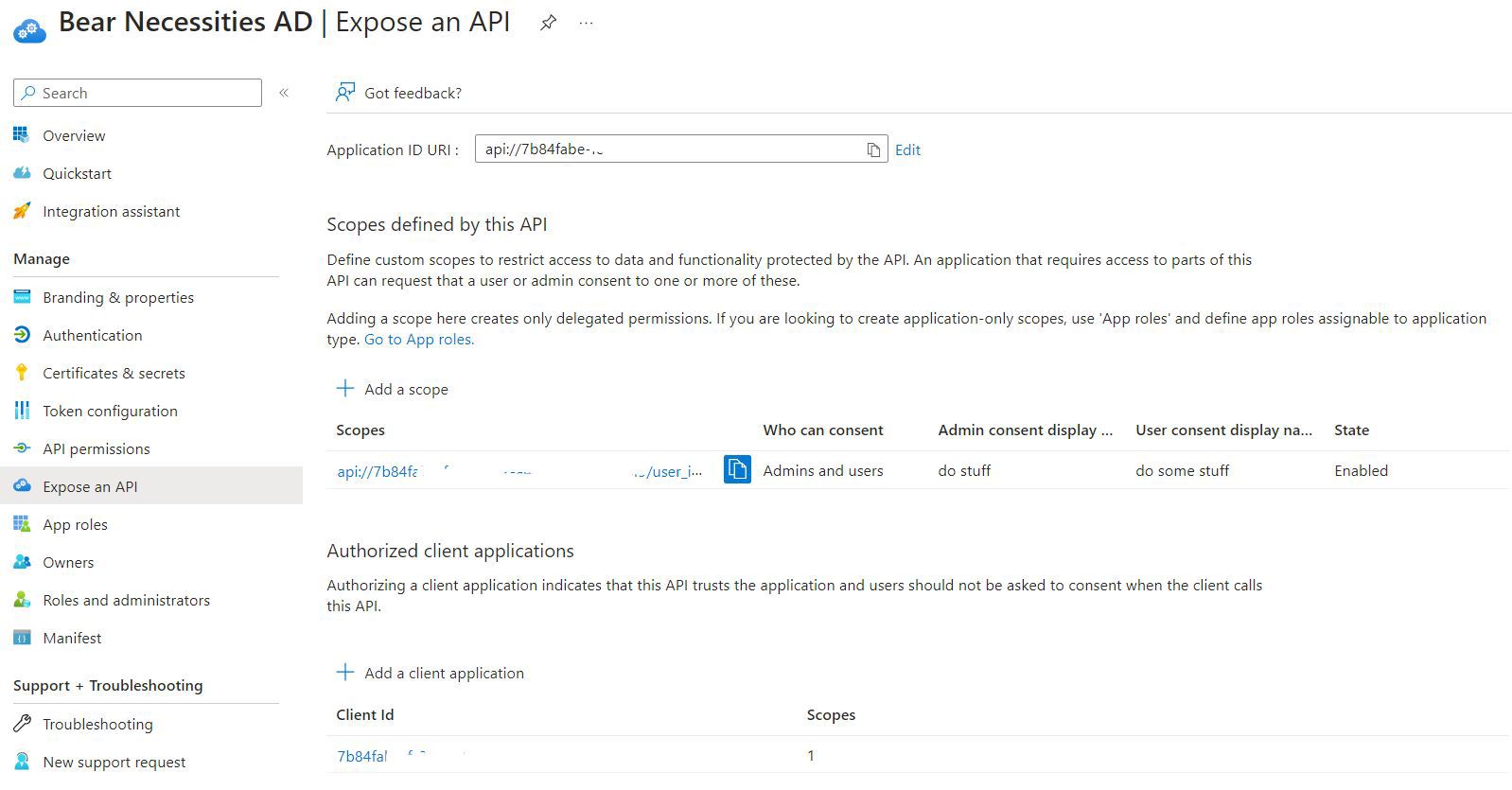

Here is my attempt to expose the api: enter image description here enter image description here

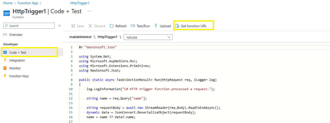

    @Young, Charles You can find the key or the function URL by navigating to your individual function and then go to Code + Test and click on Get function url.
    It will have the link and key that would be used to authenticate your function app.
