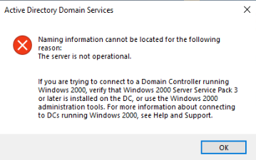

am facing some issues in my Secondary DC, when I open the active directory users and the computer gives the below error.
we thought its a normal issue because after a restart it worked fine without any issues. But what we noticed this issue keeps showing after a couple of days. then again we need to reboot. how we can fix it and what would be the reason?
