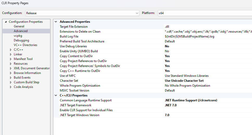

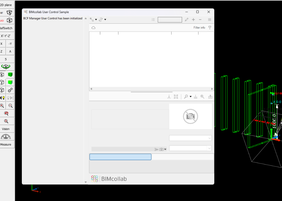

I am working on a project where I am using a .NET library in native C++ via C++/Clr. I can execute the code and the dialog from the .NET library starts correctly (https://www.bimcollab.com/en/resources/developers/developer-sdk/).
But it seems that the security protocol that is being used is not supported. I have tried to analyze the error message and think that the problem is related to the security settings.
Can someone explain how I can fix this problem? Is there any way to update or customize the security logs to fix this error?

My Setup:
.NET BimCollab library Framework 7.0

CLR / C++ Properties
C++ / CLR Code

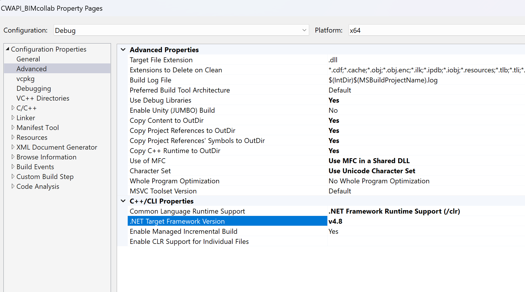

    The 3rd party application must be capable of integrating a UserControl built for .NET Framework 4.8
    The very first requirement speaks to .Net Framework 4.8. Have you tried targeting that instead of .Net 7?

    BCFManagerControlLib.dll seems library for .Net Framework 4.8.
    Therefore, NET 7.0 is probably not supported.
    ServicePointManager.SecurityProtocol in .Net Framework allowed SSL3, but it is not allowed in recently Net Core.
    I am guessing that BCFManagerControlLib.dll is trying to use SSL3 and is giving the error.
    You must create your app with .Net Framework 4.8, or request the library rebuild with NET 7.0 at the library publisher.
