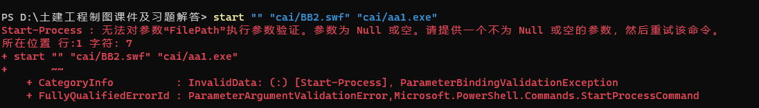

What's worse, when I opened the folder in powershell and ran this command, it failed like this.

It seemed like running command in cmd / powershell /the os.system( ) function in python can be very different.And the usage of "/"and "",and even the number of argument in the start command veried.

    start notepad.exe c:\temp\AdminTest.txt
    start "My window title" notepad.exe c:\temp\AdminTest.txt
    help start
    In a Powershell prompt:
    start-process notepad.exe C:\temp\AdminTest.txt
    start-process notepad.exe -ArgumentList C:\temp\AdminTest.txt
    get-help start-process
