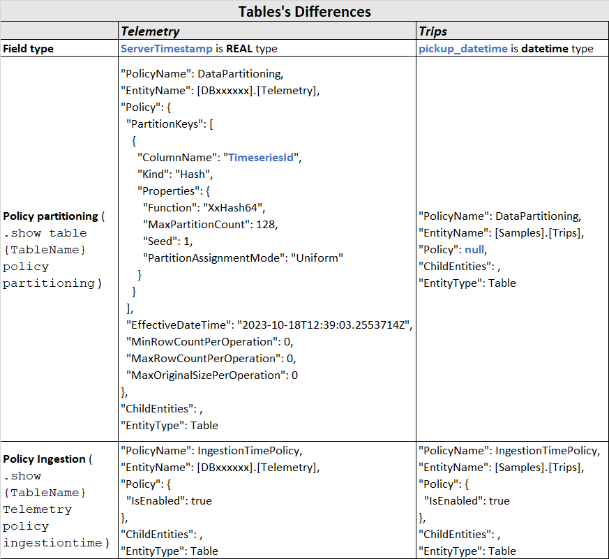

The partition is applied only on TimeseriesId field and the default on ingest_time
I have an use case where I need to find the last ServerTimeStamp of a specific TimeseriesId

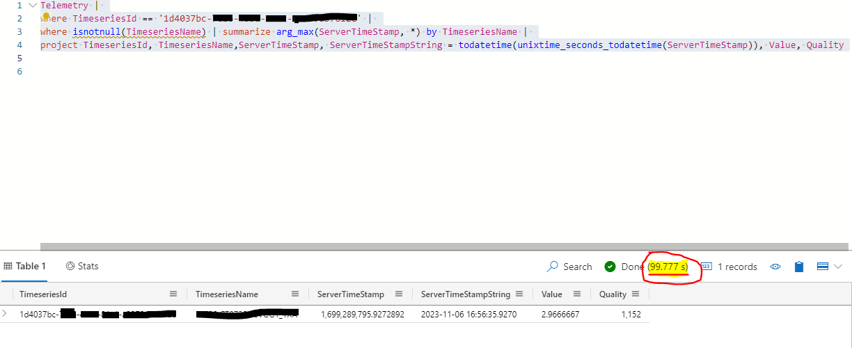

When I have performed the followed query
Telemetry |
where TimeseriesId == '1d4037bc-xxxx-xxxx-xxxx-xxxxxxxxx' |
where isnotnull(TimeseriesName) | summarize arg_max(ServerTimeStamp, *) by TimeseriesName |
project TimeseriesId, TimeseriesName,ServerTimeStamp, ServerTimeStampString = todatetime(unixtime_seconds_todatetime(ServerTimeStamp)), Value, Quality

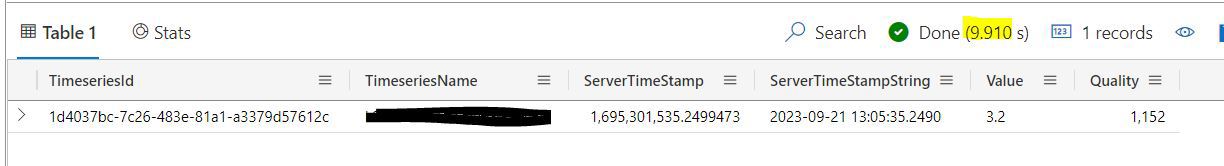

The result is gotten about in 99 sec, as we can see from the followed image
querytoomuchlong

  1. Sander van de Velde | MVP 36,766 Reputation points MVP Volunteer Moderator
    2023-11-06T22:56:56.41+00:00
    Hello @Galgani, Stefano ,
    it's hard to optimes a table out of the blue.
    It's not clear neither how many records there are in the table, how large your cluster is, nor how much of the data is available in the cache.
    Any KQL query acts like a funnel so I would put the largest filter at the top.
    You say you need to find the last ServerTimeStamp of a specific TimeseriesId so I would leave out the TimeSeriesName part.
    the arg_max seems to be able to find the latest date already:
    Telemetry | summarize arg_max(ServerTimeStamp, *) by TimeseriesId | where TimeseriesId == '1d4037bc-xxxx-xxxx-xxxx-xxxxxxxxx' | project TimeseriesId, TimeseriesName, ServerTimeStamp, ServerTimeStampString = todatetime(unixtime_seconds_todatetime(ServerTimeStamp)), Value, Quality
    Does this help?

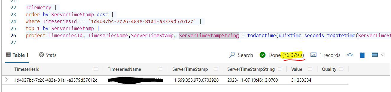

    Otherwise, an alternative is this top 1 by solution:
    Telemetry | order by ServerTimeStamp desc | where TimeseriesId == '1d4037bc-xxxx-xxxx-xxxx-xxxxxxxxx' | top 1 by TimeseriesId
    Try to find out which part is slowing you down by 'pealing off' statements of your query.
