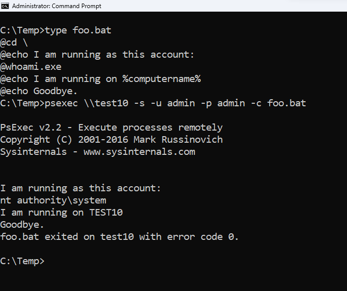

    Like this.
    psexec \\pcname -c delprof2.exe /ed:(Username)* /d:60 /q /u /ntuserini
    If you have multiple commands that you need to execute, you can tell psexec to copy a bat file that can execute the command sequence.
