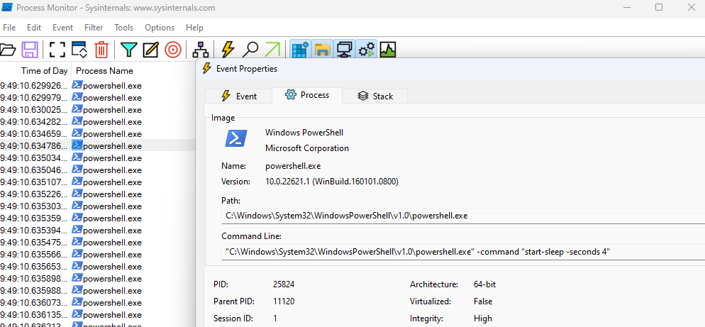

    Add a filter entry for "process name starts with powershell". In the option menu, select Enable Boot Logging. Then reboot. Log back in and launch procmon. Stop the capture and then look to see what script the command line is pointing to and what the parent PID is. That is the process that launched Powershell.

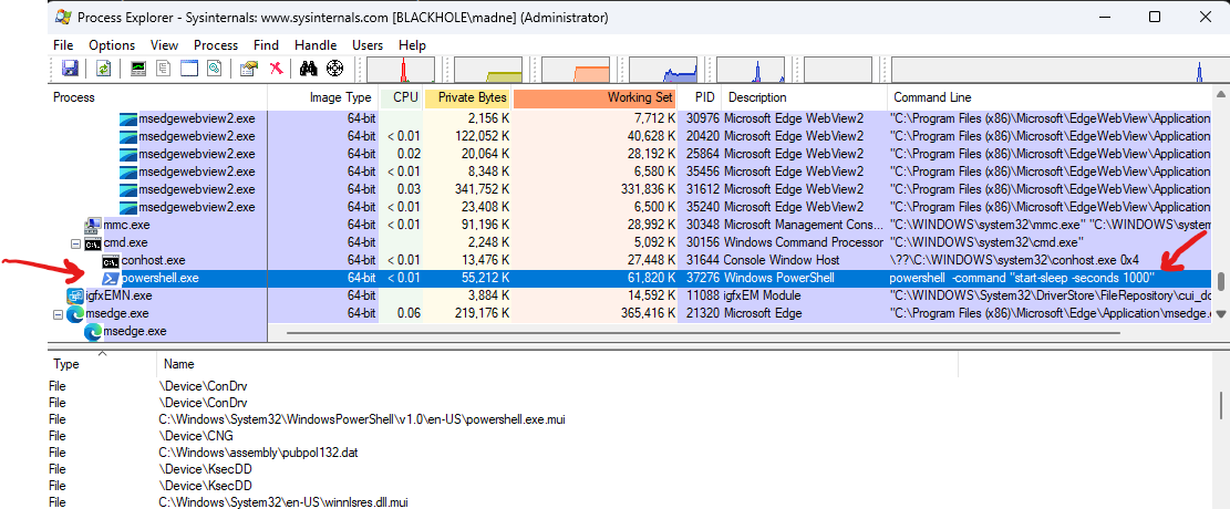

    Here I caught a scheduled task. Click the red block to stop the script.
