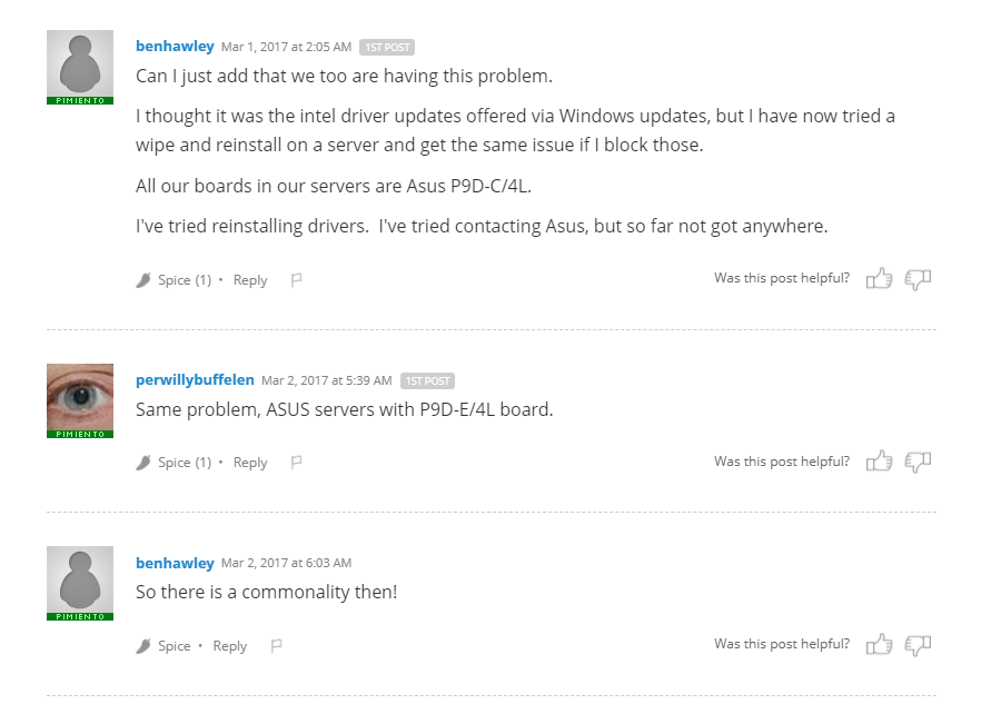

I have two identical ASUS P9D-C motherboard servers. About four months ago both of them stopped accepting a reboot command and simply shut-down. After chatting with ASUS they have advised me that this is clearly a Microsoft update issue. No other server I administer has this issue, only these two ASUS.
There was a post about Intel Management engine interface back dating a driver to 2013 but I found that effortless. (Intel C22x MEI NULL HECI driver file).
All of it seems to happen with the same MoBo
