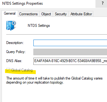

    Great information, thanks. Testing is a good point to start (for example moving to another site and removing GC before decommissioning);besides you can validate the procedure that you did it to move the 5 fsmo roles and DNS :
