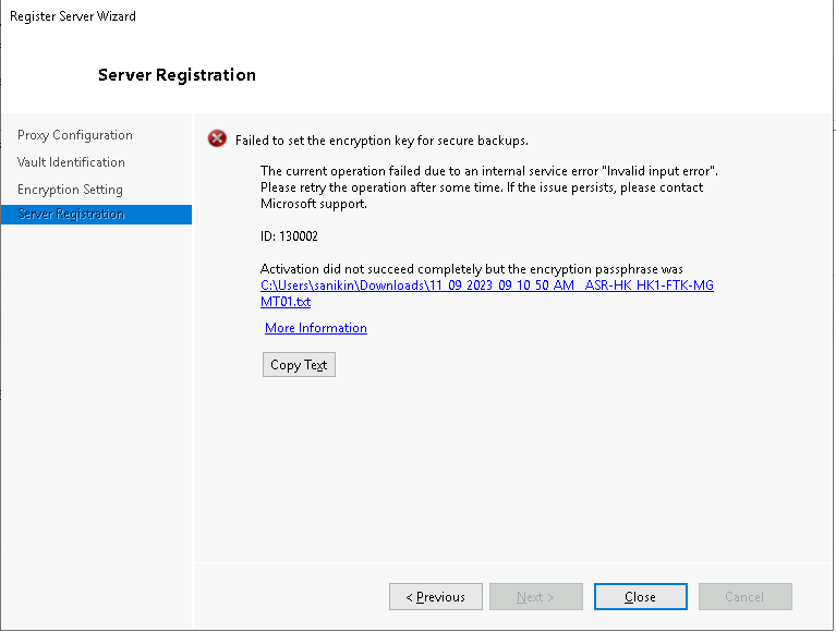

Hi there. I can't remove Recovery Service Vault, because security settings are grayed. I had a VM that backed up folder to the cloud, but a week ago I stopped backup. It seems something went wrong and I now in the dead lock. I can remove Recovery Service Vault, because the backup item exist and disabling soft deleting doesn't support.
When I tried to reinstall Azure Backup agent on the host the error 130002 was appeared.

    @Semen Anikin - I have checked the details of the case and it seems you have removed and deleted the data source from backup on 09-Nov and this data is currently in soft delete state for 14 days. Once 14 days is completed which is on 24-Nov then you would be able to remove the MARS registration from vault and then delete the vault.
    I wish there was a way for you to remove AlwaysOn Soft Delete but currently it is not available.
    Just to update you that Microsoft does not charge you for 14 days retention of data in soft delete state. But if you immediately want to delete the vault and does not want to wait for Soft delete period then you can reply on the case and the backend team will help on unblocking it from the backend.

    As per the first image it seems that Always on Soft Delete option is enabled on the vault due to which you are not able to disable soft delete option on the vault.
    This would need help from the backend to remove the Always on Soft Delete option on the vault which will allow you to remove the backup item on the vault and further remove the vault.
    So, I would advise you to please open a ticket with Azure Backup team and ask them to help on disabling Always on Soft Delete option on the vault(Support team will reach out to Product Group with a business justification and then Product Group will help in disabling the option from backend).
