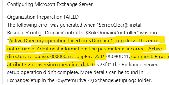

    I've been searching on the errors you provided earlier and found the article below which includes the similar error messages:
    Error when you install Exchange Server: Organization Preparation FAILED
    From the article, we can learn that the error can be solved by changing the value of the lDAPDisplayName attribute to msExchResourceSchema. But seems like this cannot be adapted to your situation because we cannot identify the schema object using the current information included in the errors. Did you by any chance see any additional error message from your end which might help locate the culprit schema object?
