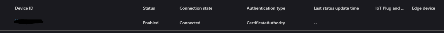

The connection is successfully made to IoT Hub, but the device no downloads the message, it is as if it did not receive it.
My scripts, both the one for sending telemetry and the one for receiving messages are based on the C codes downloaded from here:
https://learn.microsoft.com/it-it/azure/iot-hub/iot-hub-mqtt-support
My devices authenticate with X.509 certificates and everything has always worked properly, I have been using this system for almost a year.

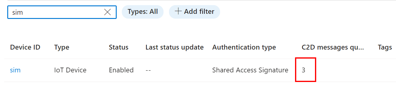

In the past few days I started having problems on sending messages from cloud to device: from Azure interface the message shows correctly sent and queued, but to the device it is as if it never arrives.
