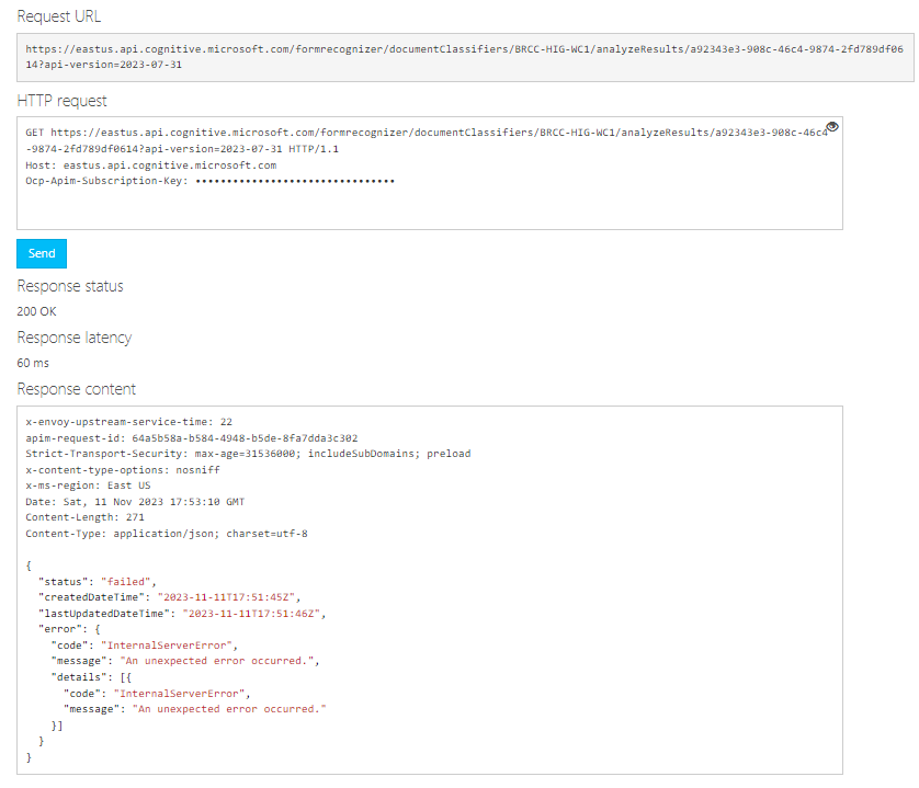

When testing the Get classifier analyze result API call on your API test console, I get an Internal Server Error, with no details on exactly what the problem is. I had written some code that was working, and then I started getting this error (when running my same test file), so I tried it on your test page and got the same error. For this test, I generated a PDF using a Microsoft Word Template.
The attached screenshots show the "Classify document" call and also the "Get classifier analyze result" call. I have also attached the test PDF.

    I figured out what the problem was. I had trained the model using the previous version of the API, and this caused the error when calling the API. It would allow you to submit classify the request successfully, but the "Get classifier analyze result" errored.
    I created a new model and trained it using the version that matched the API call and it worked.
