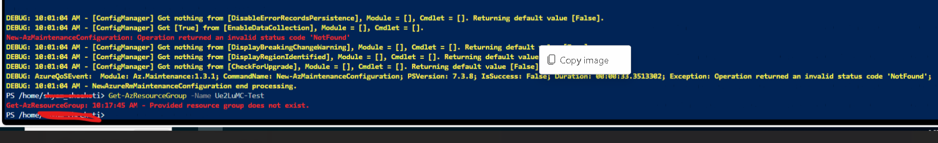

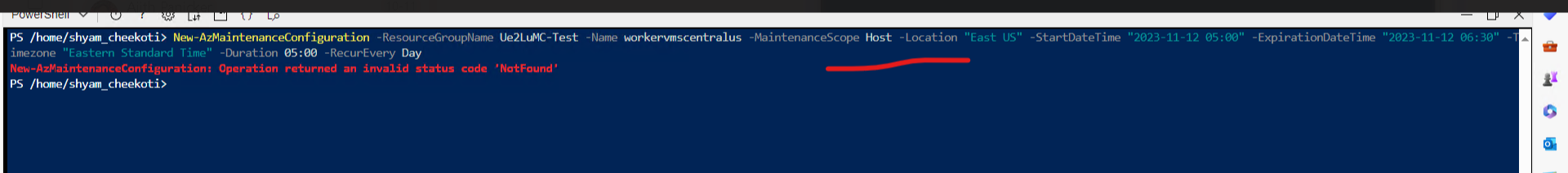

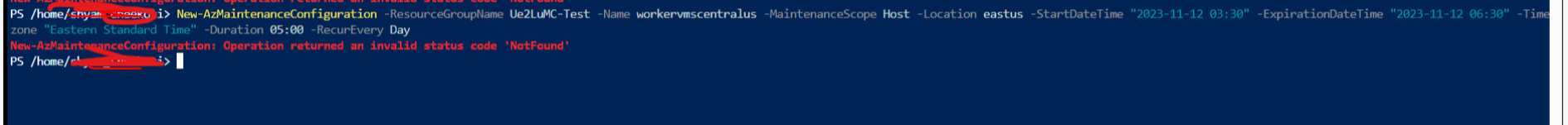

I am trying to create maintenance configuration using azure powershell, I see bad request and not found errors. Please see below screenshot and suggest. thank you

    Your ExpirationDateTime (2021-11-12 06:30) is before your StartDateTime, and your StartDateTime appears to be incomplete/incorrect. Please fix those two things and test again.
