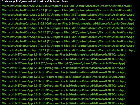

    We have a pipeline using Devops Task "App Service Deploy", on the other end for test purpose, we also use the publish from VisualStudio.
    In the publish manner we set SelfContained to true and my API works fine (if i don't i have the same problem).
    Further in the analysis i see that :
    • When the API does not find the runtime i have this in the runtimeconfig.json
      "runtimeOptions": {
        "tfm": "net7.0",
        "frameworks": [

    • When the API does work fine we have the right value.

    IUser's image
    I am still working on the way to correctly set the value on my Azure Devops pipeline
