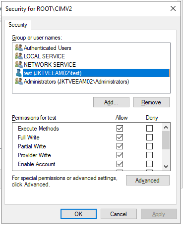

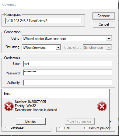

Hello,
i do WBEM test to remote server using administrator and WBEM result is ok, but why if i got 'Access Denied' if try connect using another account (in my case i use test account).
User 'Test' is member of administrator groups, so in my mind the WBEM test should be ok if i use this account.

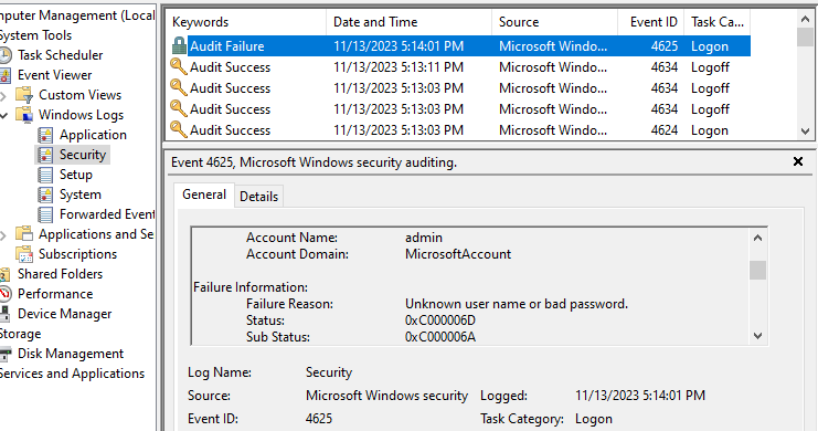

  1. MotoX80 37,156 Reputation points
    2023-11-13T22:46:21.8366667+00:00
    Check your security eventlog for logon failures. (You may need to check your audit policy to verify that you are logging logon failures.)
    I have 2 VM's that I play with. On one I tried to connect with my testuser and got this error.
    I added that account to the administrators group and then it worked.
    Then I was playing around and found that if I type in the wrong password, then I get the same error that you got.

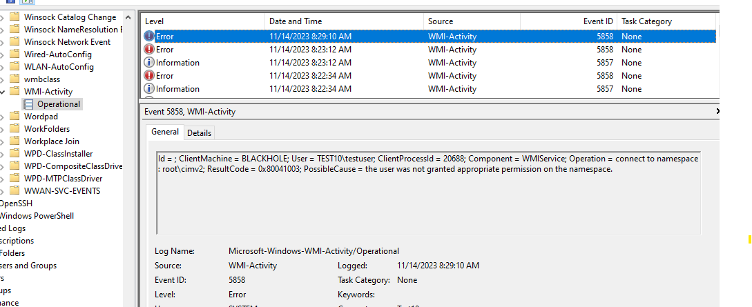

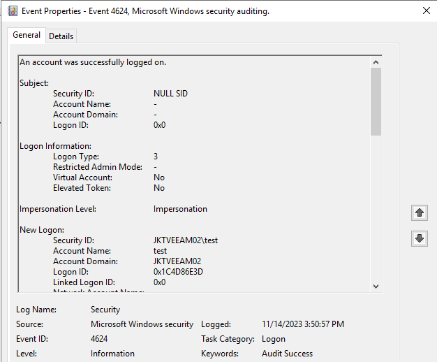

  1. Handian Sudianto 6,541 Reputation points
    2023-11-14T08:55:08.9433333+00:00
    Hello @MotoX80

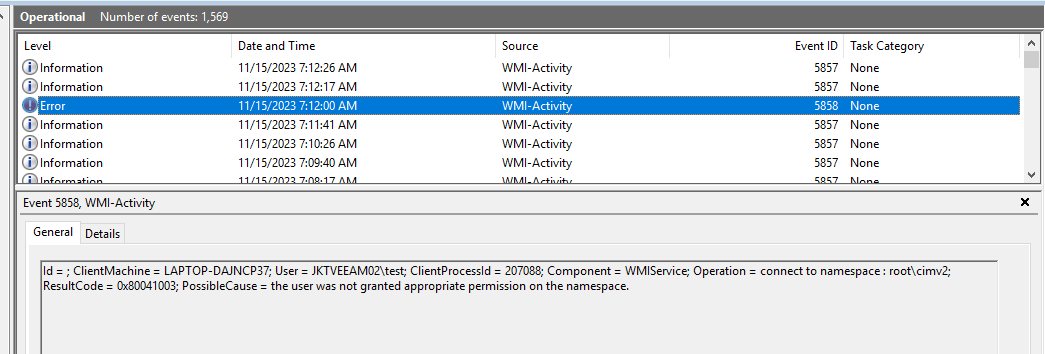

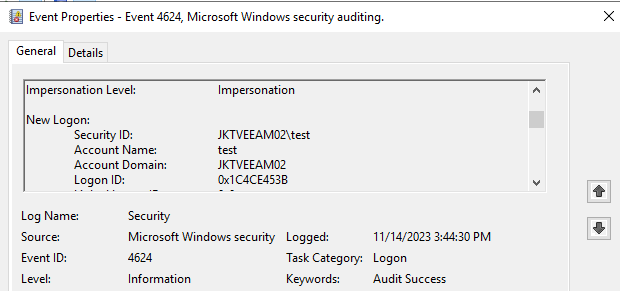

    in event viewer i got this message
    Account logon successfully but WBEM test result is failed.
