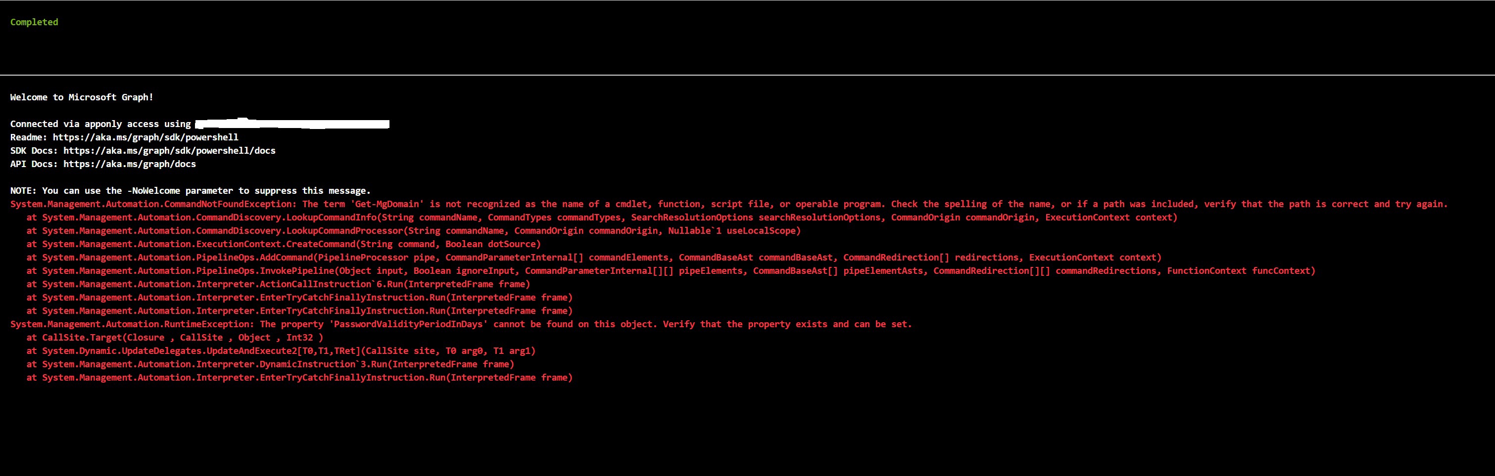

I want to run a powershell script on azure automation, but it requires to connect to Microsoft graph. I tried in many different ways, but it gives me errors. Is it possible to do this? What is the correct way?
