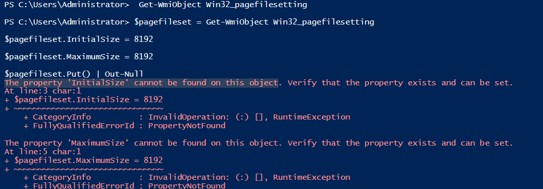

We have an issue with a script we are running on devices via Intune. In the last 10 devices, 2 succeed, but the rest fail. And because of the way the status page works, it doesn't give any further info. So what I am hoping is I can share the script below and see if anyone has any suggestions to modify it. It used to work across the board, but recently this has been mostly failing. All it does is sets the virtual memory to 8192 MB is all.......
$pagefileset = Get-WmiObject Win32_pagefilesetting
$pagefileset.InitialSize = 8192
$pagefileset.MaximumSize = 8192
$pagefileset.Put() | Out-Null

    @Matt Rosier, Thanks for posting in Q&A. For your command, based on my testing, when I manually run one device, I get error "The property 'InitialSize' cannot be found on this object".

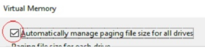

    After researching, I find when Pagefile is automatically managed, we can’t modify the setting so we need to remove that box. change the Virtual memory, we need to uncheck "Automatically manage paging file size for all drives".

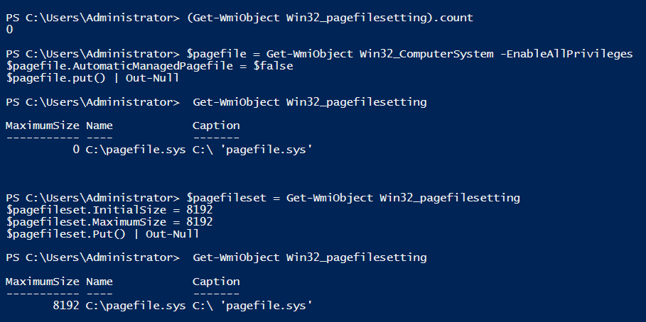

    Here is the code to uncheck the setting:
    $pagefile = Get-WmiObject Win32_ComputerSystem -EnableAllPrivileges
    $pagefile.AutomaticManagedPagefile = $false
    $pagefile.put() | Out-Null
    After running the above code, I find the virtual memory can be set.
    For your scenario, you can try the above suggestion to see if it can work. Hope the above information can help.
