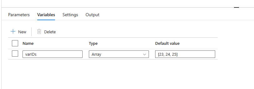

    I do not have a Salesforce instance to replicate the same but, I have tried with SQL and was able to overcome the issue by forming a query as below:
    I have a array variable as below and formed a SQL query as below using dynamic expression to make it work
    select * from dbo.employeelookup where employeeid in  @{replace(replace(string(variables('varIDs')),'[','('),']',')')}
    The above expression will form a query as below during runtime:
