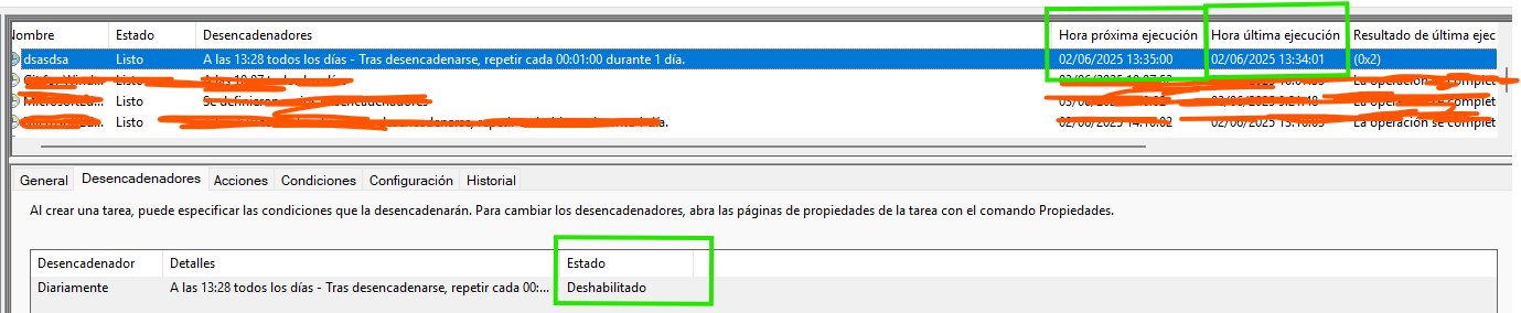

I wanted to test starting a scheduled task manually from PowerShell, so I disabled its trigger which was set to run the task every 15 minutes. To my surprise, the task still ran every 15 minutes despite the disabled trigger. Is this the expected behavior on Windows Server 2019? If so, what is the purpose of the Enable/Disable trigger checkbox? Thank you.

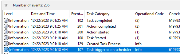

    • Can the task history offer any insights into how the task behaves? User's image
