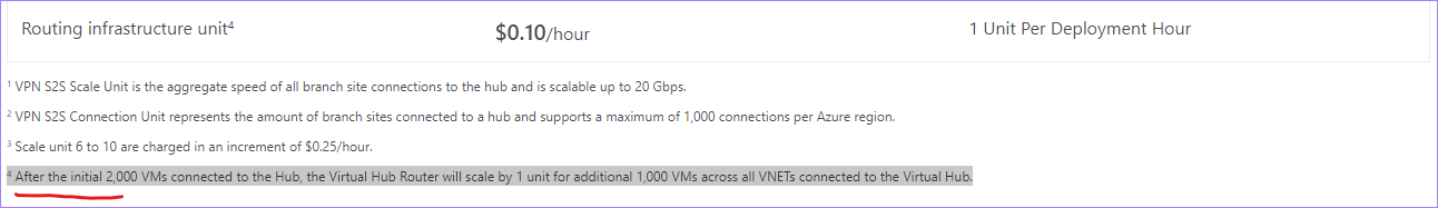

    As per the pricing for WAN . you can consider following additional charge for Virtual Hub Router.
    And as documented here. All of the virtual hub routing is provided by a router that enables multiple services in a virtual hub. There's a base fee for the hub, which is priced at $0.25/hr. There's also a charge for data processing in the virtual hub router for VNet-to-VNet transit connectivity. The data processing charge in the virtual hub router isn't applicable for branch-to-branch transfers (Scenario 2, 2', 3), or VNet-to-branch transfers via the same vWAN hub (Scenario 1, 1') as shown in the Pricing Components.
