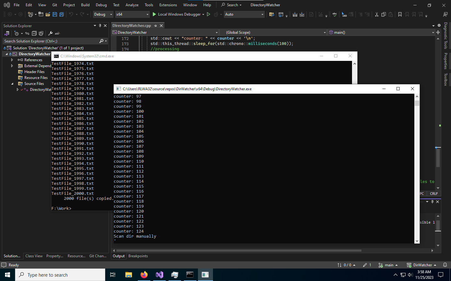

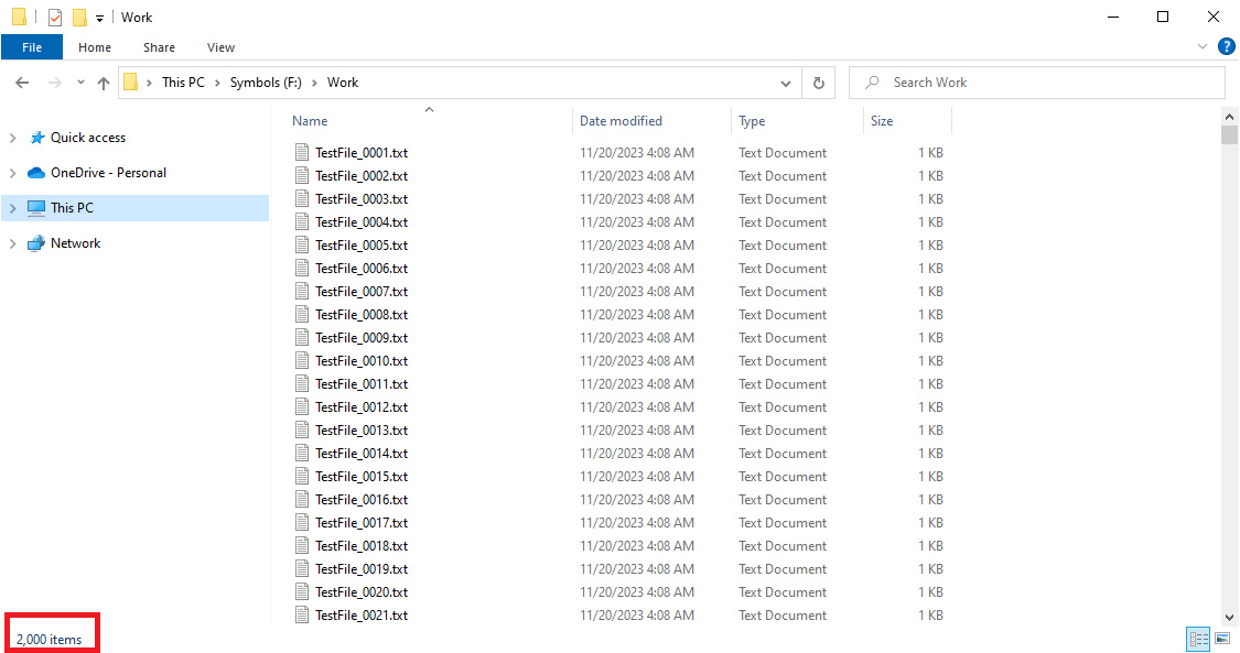

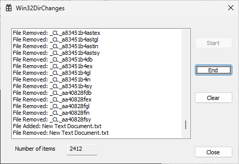

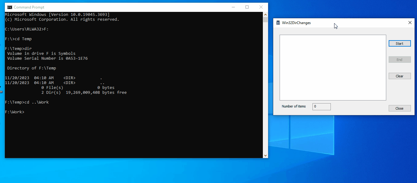

  1. RLWA32 51,831 Reputation points
    2023-11-20T12:19:33.18+00:00
    You can download the sample the I used to test from https://1drv.ms/u/s!AmnqrCFBv4nDhB_xJ8Ry0GqL4vRJ?e=7XV1CO
    It is a basic Windows API dialog-based application created using VS2019.
    Make sure to unblock the zip file before extracting the contents.
