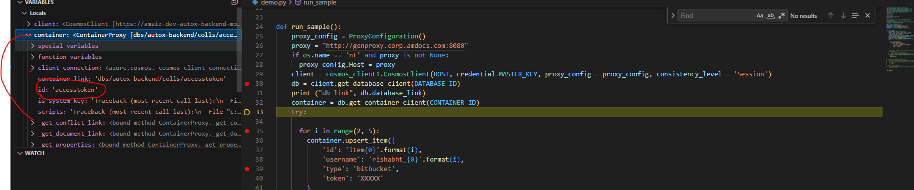

I am getting 404 status code when I am doing any of the operation using CosmosClient.
I have cosmos db (mongo) setup in my subscription. While debugging I could see the "get_database_client"
& "get_container_client" works (as shown in the below screenshot), but all other operations ending with "Status code: 404\nb'', <class 'NoneType'>: None"

    Hi Rishabh,
    For opensource APIs such as Mongo API, Cassandra API and Gremlin, we recommend using the opensource drivers. only for the NOSQL API we have our built in SDKs.
    In your case, you can use any of the opensource drivers mentioned here. https://www.mongodb.com/docs/drivers/
    Yes if you are using Python, then you can follow the quick start here, https://github.com/Azure-Samples/azure-cosmos-db-mongodb-python-getting-started
