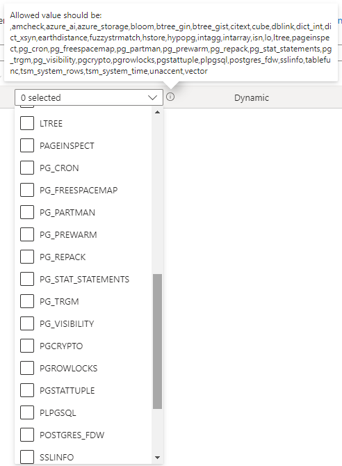

I believe it's because I have not allowed the pg_buffercache extension on the Flexible Server. However I actually can't find this extension in the list given by the azure.extension server parameter.
Is the extension not available yet or will it no longer be available ?

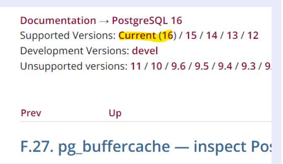

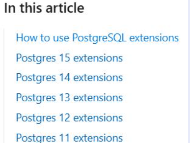

    I do not see Postgres 16 as listed version on official Microsoft Doc
    https://learn.microsoft.com/en-us/azure/postgresql/flexible-server/concepts-extensions#pg_buffercache
    However official Postgres website has this as supported version.
    I have also created two servers with version 16 in West Europe and East us and I also do not see this particular extension.
