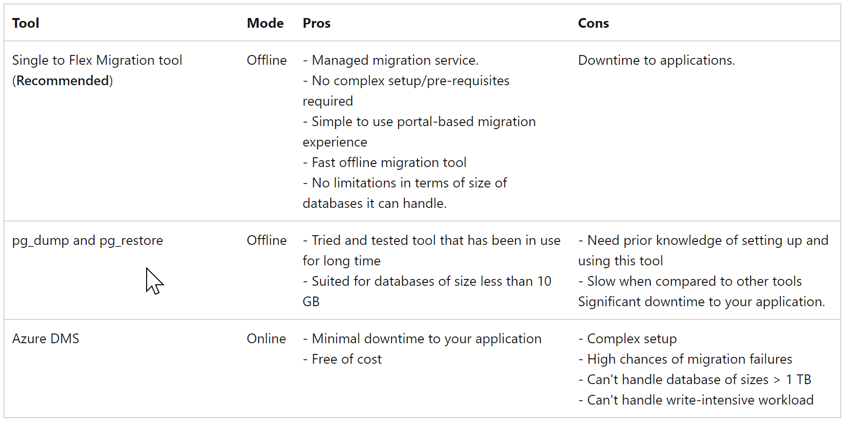

    The following table lists the different tools available for performing the migration from single server to flexible server.
    Please refer https://learn.microsoft.com/en-us/azure/postgresql/migrate/concepts-single-to-flexible for more details.
    Let us know if this helps or if you have queries.

    I'm intredted in migration tool I wrote before.
    if version are diffrent, there is no problem on migration tool?
