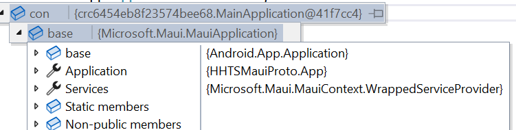

Hi, so i am working on modifying an existing maui app which is working fine in .net7, however there is a problem with the version in .net8.
After examining both instances i have determined that there is a difference between the 2 versions, which is the only difference.
In both versions i am using the code line at the bottom.
In .net7, when i examine con, i can drill down into the base and see that it is "Microsoft.Maui.MauiApplication}"
I can examine all the other properties within that without issue.
.net7
However, in .net8, with the same line, you can see the base, but underneath that, all you see is the message "object reference not set to an instance of an object "
Everything else is the same, however there is something wrong in the initialisation of the MauiApplication which i believe is causing this due to .net8.
Can someone help me resolving this issue.
.net8
var con = Android.App.Application.Context

    Hello,
    I tried to use following code, I can get the same issue.
    #if ANDROID
                var res1 = Microsoft.Maui.MauiApplication.Context;
                var context = Platform.AppContext;
                var reS2=   Android.App.Application.Context;
    #endif
    Q&A is not a bug reporting or tracking system. Please report it in the Maui github repository at https://github.com/dotnet/maui . We will clear details to be able to reproduce and troubleshoot the problem. When you post it, please include version numbers, exact repro steps, and the difference between the expected behaviour and actual behaviour.
    By the way, if you want to get current Activity, you can use var CurrentActivity= Microsoft.Maui.ApplicationModel.Platform.CurrentActivity;, it is working as normal in .NET 8
