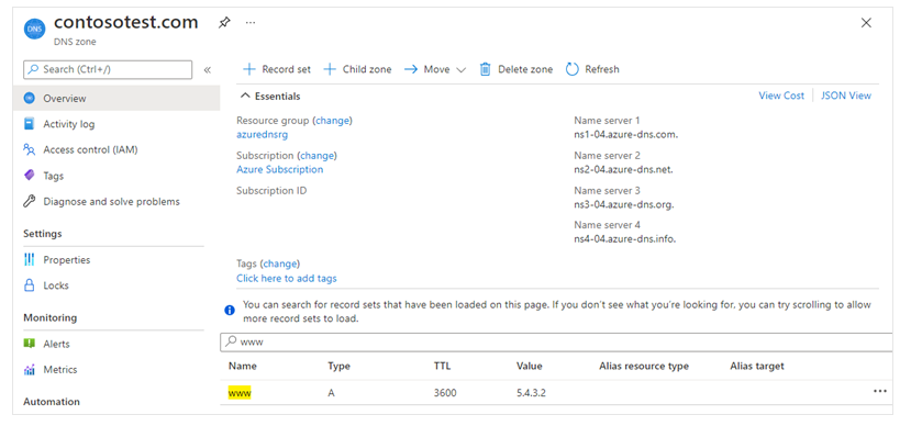

    You also mentioned "The name servers I was given, when I try to add them to my domain registrar, are not resolving to proper IP addresses, and hence they are not working."
    Do you have an A record added in your DNS zone? To be able to resolve the domain to an IP address, you should have an A record in your DNS zone as below:
    Refer: https://learn.microsoft.com/en-us/azure/dns/dns-operations-recordsets-portal
