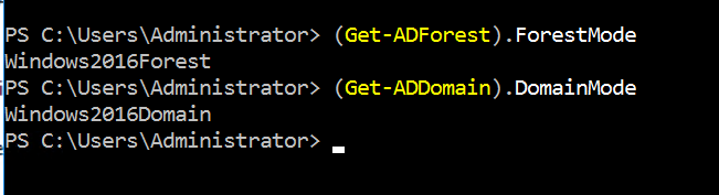

    Based on "but the AD schema version is in windows server 2003", I understand the AD schema you mentioned are Functional level (domain functional level and forest functional level).
    And you can check it via PS command below:
    (Get-ADForest).ForestMode
    (Get-ADDomain).DomainMode
    You mentioned "In fact, the customer, had these old domain controllers on win server 2003", so domain functional level and forest functional level should be 2003.

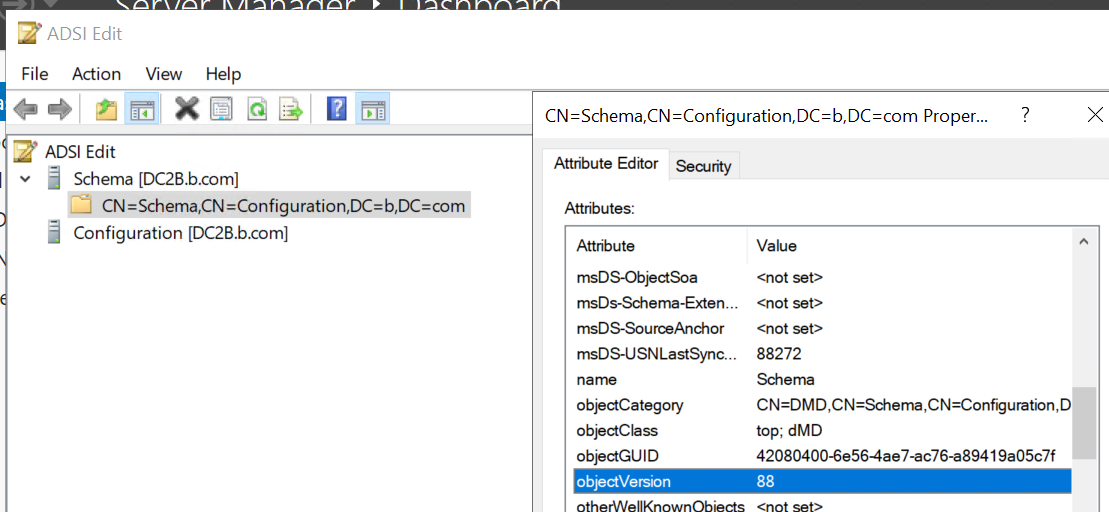

    Is the AD schema you mentioned is objectVersion below?
    In my lab, I have 2 DCs in domain, one is 2016 and the other is 2022, the objectVersion on both DCs are 88.
    Please check what is the objectVersion on all DCs in your domain.
    If you have any question or concern, please feel free to let us know.
