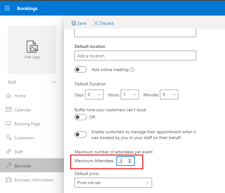

Hi, I have enabled Bookings in Teams and would like to use it to have up to 6 people schedule training sessions. However, when I click on edit services, the "Maximum Number of Attendees" option is set to 1 and grayed out so that I can't select it. Is there a way to change it

  2. JimmyYang-MSFT 58,786 Reputation points Moderator
    2023-11-27T06:07:10.2533333+00:00
    @Mariano, Vladimir G
    As far as I know, if you're trying to edit the existing services, while the maximum number of attendees for the existing services is set to 1, it's not available to change the maximum number. This is because the group bookings feature was disabled if you set the maximum number to 1 when you created the service.
