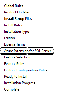

Se attached image for the SQL-Server installation setup.
EDIT: Removed Image
According to https://learn.microsoft.com/en-us/sql/sql-server/azure-arc/manage-configuration?view=sql-server-ver16&tabs=azureIt shoulld basicly be a next-next installation. We have tried following that instruction on a Hyper-V host and it works without issues but doing this on the vmWare host PAYG option is greyed out

    I believe there is an issue in the SQL Server setup that causes the Azure Arc connection fall out of Setup when you are on VMWare. You may note that that Azure Arc extension for SQL Server is missing from the ToC to the left:
    I have run into the same issue on VMWare workstation.
    This is no showstopper. Just get a product key, and then you can enable PAYG from the portal. As I understood it, you have already Arc-enabled the OS, and the agent will find SQL Server and enrol it automatically.
