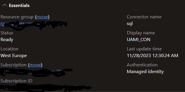

Manually configured connection in the portal provides me with:

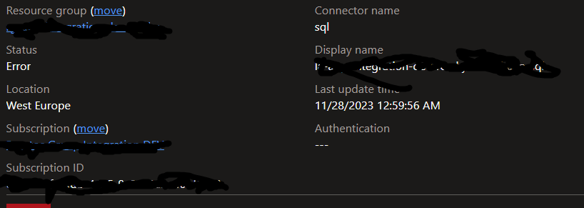

Is resulting in:
To be fair, it should not be hard to find an answer on this for what the possible values of 'Authentication' can be for your connection and how you should deploy the different types of Authentication ..

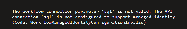

The Error:

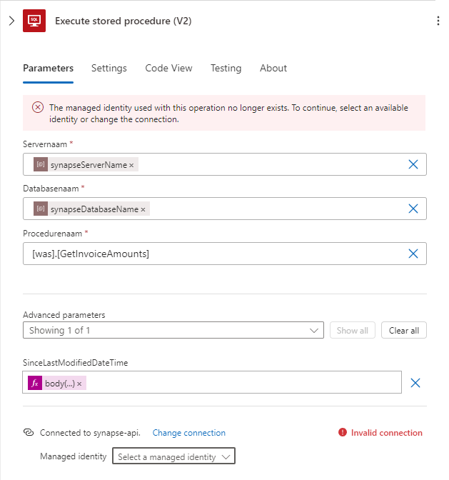

  1. Martin Peters 6 Reputation points
    2024-07-30T08:16:45.84+00:00
    Although the solution works for me as well, I still have an issue after a deploy in a clean resource group. When I open the designer it reports "Invalid connection". After I select the user assigned managed identity from the dropdown, a new connection is created in the connections.json file with the same content. Then the designer is happy. I cannot see the difference between the connection which is deployed and the connection which is created using the portal. Did anyone had the same problem and found a way to solve it?
