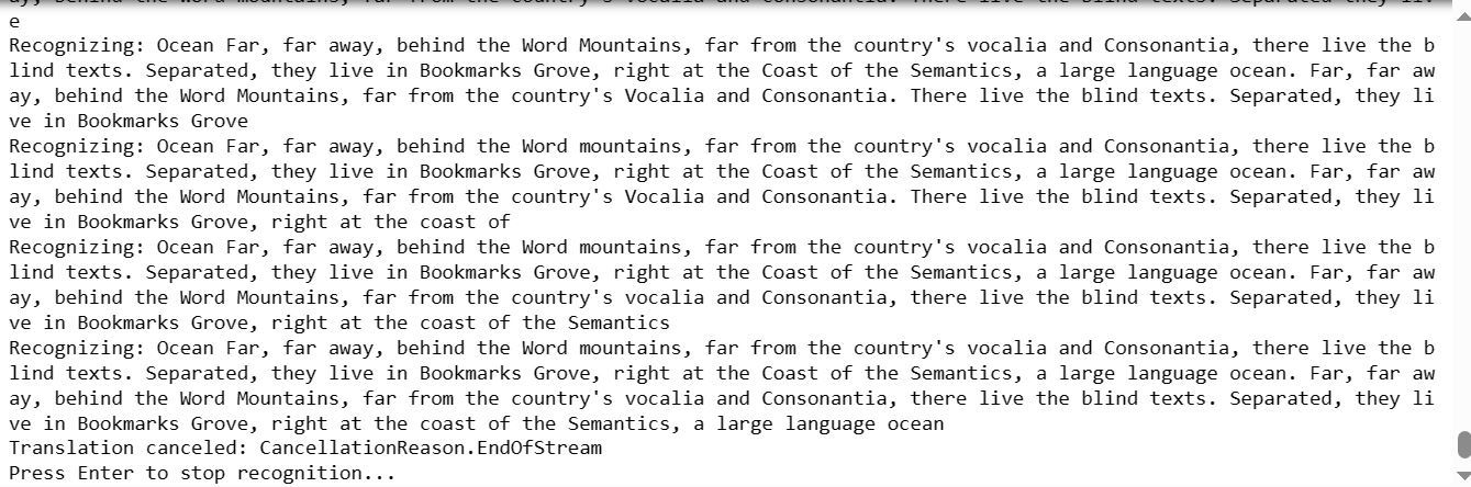

  1. dupammi 8,615 Reputation points Microsoft External Staff
    2023-11-29T16:56:24.2666667+00:00
    Hi @Harish A ,
    With respect to the "Not implemented" error, you can report the same through SDK github page where the SDK team could advice on the error.
    As a workaround, I have tried extracting individual words/phrases sample with the "SpeechRecognizer" as mentioned in my first comment. It works to recognize the words.
    You could add your file in the GH issue for the service team to check and advise on the "not implemented" error in your case.
