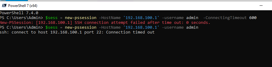

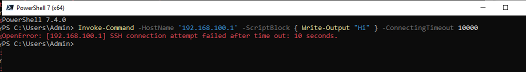

I'm currently working with a script that utilizes the Invoke-Command over SSH as shown below. While it works well, I'm looking to implement exception handling, specifically for scenarios where the remote server is not reachable.
Invoke-Command -HostName '192.168.100.1' -ScriptBlock { Write-Output "Hi" }
When the remote server is not reachable, I receive the following error message: "ssh: connect to host 192.168.100.1 port 22: Connection timed out" The challenge is that the script halts, and I have to manually abort it.
So as the script just stops I do not know how to handle such an error as following code just does not get executed. Is there any recommended approach or fix to implement proper exception handling in such cases?
